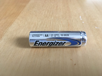

Hi, I replaced the CMOS battery from my 486 board (Soyo SY-25K2) with a battery box with 3 AA lithium batteries. It had originally a Varta NiCD battery of 4.5 V. I connected the battery box to the designated connector.
At first everything looked fine, but yesterday I noticed that the clock was running behind, and tonight the BIOS lost all it's settings. Is it possible that I need a 4 x AA battery box delivering 6 volts? Or could something else be wrong? It did retain BIOS information for a short time, because the PC had been off before (but maybe not as long?). I also connected it as described in the motherboard manual, pin 1 positive, pin 4 negative.
If 4.5 V is correct, I should look into bad connections or whatever.

The picture from the web shows a standard 3.6v Nicad barrel battery on the same SY-25K2 board, not a 4.5v. Yes pin 1 = +, pin 4 = -. Are your Lithium batteries 1.2v or 1.8v ? If they are 1.2v then yes you need 4 (for 4.8v). If they are the very new 1.8v type then you only need 3. The external battery should be about 0.5v to 1.0v more than the old onboard. added: Perhaps someone replaced some parts (diodes, battery) and it now requires a higher voltage but that would be rare. Can you post a good close picture of the battery area please ?

And these are the batteries that I used:

Addition: After power off, the clock only seems to have run for about 5 or 10 minutes. After about half an hour of power down it run behind 25 minutes or so. The settings have stuck for now, but they were last this morning.

Quick addendum:
Using a 4xAA box didn't work either, and when I measured the voltage across 4 lithium cells, it was 6.9V! With 3, I got 5.2V, seems more than enough. I then measured if there was any voltage on the mainboard… and nope 😐 Seems like the Arduino jumper connectors I bought don't fit or are just bad junk. I don't know. Because I don't know how to obtain a proper 4-pin battery connector from a local supplier I just brutally soldered the leads of the battery box to the header pins. And well, that works! 😁
So for all the other owners of a Soyo SY-025K2 mainboard: it works fine with 3 Lithium cells on the external battery connector. Just make sure you have it properly connected.
