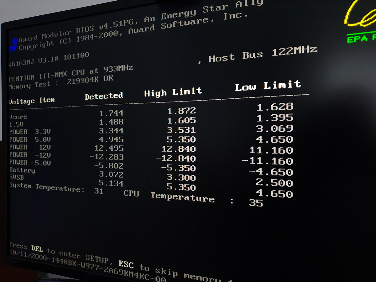

Hello guys,
I have what I consider to be a very nice 440BX board (MSI MS-6163 ver 1.0), which is probably as close as it gets to perfection for Pentium 2 Deschutes / Pentium 3 Katmai CPUs.
Now, since the board supports FSB frequencies up to 150 MHz (I'm actually running a Pentium 2 350 MHz CPU @ 504 MHz with a 144 FSB setting and it's unbelievably fast and stable), I really want to try out a Coppermine CPU. I also updated the BIOS to the latest one (which is actually for the Pro version of the board, but it's also supported by ver 1.0).
The issue is that the board only supports 2.0 - 2.4 CPU voltage (configurable in BIOS) and Coppermines are safe up to about 1.8V max.
So you can understand my frustration that, even though I'm 100% sure this board could perfectly handle Slot 1 Pentium 3 CPUs, my hands are tied because of minimum voltage.
Does anybody know of a miraculous solution to this problem, anybody else that might have the same or a similar board?
I know about the Powerleap slotket adapter which supports lower voltages, but I actually want to run pure Slot 1 Coppermine CPUs.

UPDATE:
So, I finally got the chance to play with the Pentium 3 Coppermine 700 MHz CPU on the MSI MS-6163 ver 1.0 board.
First thing I did (with the old Pentium 2 CPU) was to set the BIOS voltage to AUTO and the frequency to 100MHz x 7.
I rebooted, powered off the board, installed the P3 700 MHz CPU and.... BINGO! To my amazement, not only did it instantly boot, but the actual voltage switched to 1.65V 😁
I accessed the BIOS and the voltage/multiplier options have changed, compared to before, when the P2 was installed. I can now choose between 1.65V - 2.00V, and multipliers up to 8.5.
I immediately set the FSB to 122MHz (fun fact: in order to get an effective 133MHz FSB, you need to set it to 122MHz in the BIOS - this is probably a bug caused by the latest BIOS update, which is in fact for the Pro version of this board).
Also set the voltage to 1.75 (but I will also test with 1.7, it could work too), booted into Windows, benchmarked the hell out of it for more than two hours and it works like a charm. 😀
So, as I guessed, this board is a keeper!

Reply 13 of 24, by bloodem
UPDATE 2:
Tested the CPU with 1.7V ---> stable.
So I went for 1.65, the default, and so far it's also stable. Not sure if this is common with these chips, but I'm impressed. It seems that this CPU could have easily been sold as a 933 or even 1 GHz part.
