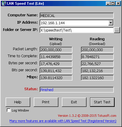

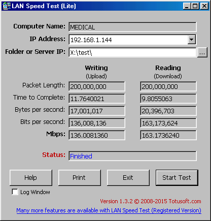

I've got myself an Intel Pro/1000-GT network card and made some speed tests with 98SE and XP on my Tualatin 1.4GHz.
On both systems I've run TCP Optimizer beforehand and pushed the slider all the way to the right to optimize the settings for Gigabit connections.
I am transferring a file onto an SMB share that is running with Samba 3.6 (external 2TB harddrive connected to my router).
This is Windows 98SE:
10.49 KiB
1054 views
This is Windows 98SE with "interrupt moderation" turned off in the settings for the Intel card:
10.55 KiB
1054 views
Slight boost, but not much.

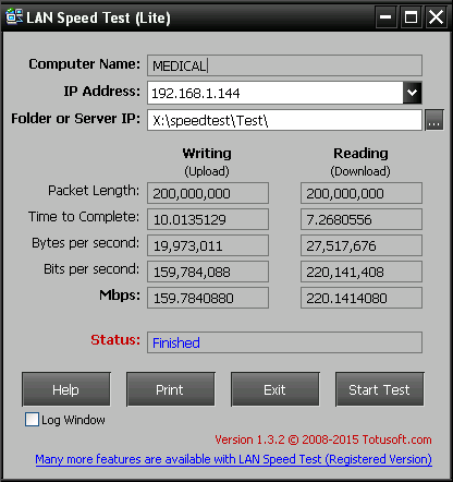

This is Windows XP:
10.51 KiB
1054 views
That's a lot faster!
The CPU is only around 50% utilized on Windows XP, which is weird, though.
Maybe the harddrive that's connected to my router is getting maxed out? Or the SMB protocol is badly optimized for speed?
Guess I'll need to run more tests...
