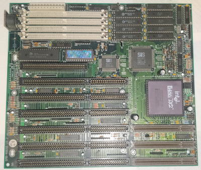

Reply 8 of 22, by Anonymous Coward
Please post a high resolution picture of your FU3 motherboard.
I should really try setting my external cache as 64kb to see if the BIOS will pick it up. I remember Feipoa had issues getting 256kb cache to work on his FU340 with AMI BIOS.

Reply 11 of 22, by Anonymous Coward
Your board seems basically identical to mine, and has the same B1 stepping chipset.

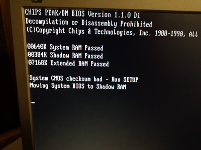

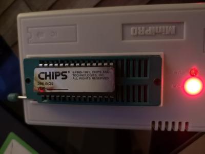

Reply 13 of 22, by Joyride
Hi! Maybe i can help you.
Im working on a Chips PEAK/DMmotherboard right now that looks like yours.
I cant get it to boot. I have tried flashing it with AMI bios but then it wont even turn on.
Anyway i have saved my BIOS if you would like to try it out.
Here is a picture of the board and the attached bios:
