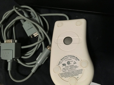

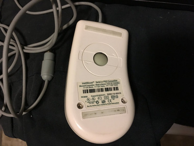

Not all the MS Intellimouse PS/2 were fully serial compatible. Those that were actually stated "Serial or PS/2 Compatible" or "Serial - Mouse Port" on the bottom label though most of the v1.1 seem to work just fine with a serial adapter. I have a few MS that are truly serial+ps/2 compatible and state it or included a serial-ps/2 adapter. Have you tried a real serial mouse with two serial-ps/2 adapters (one into the KVM and one out of the KVM) ?
Added: Are you sure you do not have a bit of a port conflict ? Be sure to use COM1 , 3F8, IRQ 4 for the mouse as nothing usually interferes with that UNLESS you choose IRQ4 on something else 😀
