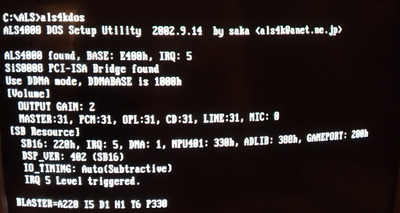

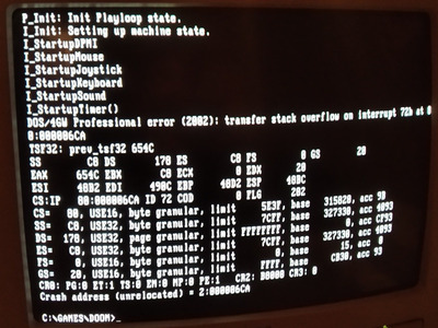

My problem, is that i read you people are using a ALS4000, and play "doom"
I have a ALS4000, i tried original drivers and the new ones found in this forum, and everything works great EXEPT doom (and doom2, heretic, etc) whatever driver i use
I tried DMA legacy, IRQ5-7, SB PRO mode, etc etc no luck

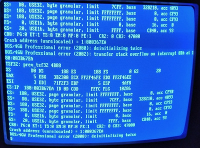

Doom,2,heretic, etc works FINE if no sound FX (only music adlib or SB), but if I select FM sound, i get this crash

I even replaced DOS4GW with DOS32a... still hangs

Hi Philippe! thanks for your repply
I just found a way to solve the problem, in the Futro bios, i set all IRQ EXEPT 5 or 7 to RESERVED, and 5 or 7 to "PCI Device" then force the sound card to use same IRQ as the one was assigned in config
Works fine now, thanks for your reply

I realize even if the "virtual" IRQ in config was 5 or 7, the PCI sound card was using IRQ 10.... think... maybe better to use same physical as virtual IRQ... and worked

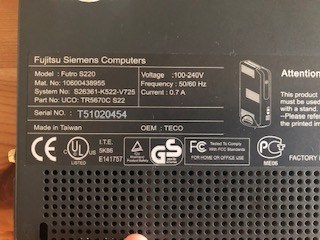

PC MODEL
Fujitsu Siemens Futro S220

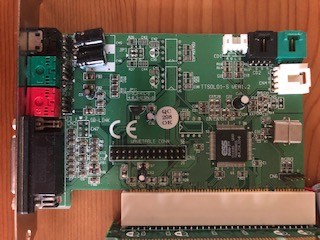

Terratec ESS Solo-1 TTSOLO01-S VER1.2
Chip: ES1938S
27.15 KiB
993 views
I used the sound driver from Vogons
drivers download page for ES1938 at:
https://www.vogonsdrivers.com/getfile.php?fil … =60&menustate=0
The driver from Phils Computerlab did not work for me, because it wanted
me to install the driver through a win9x instalation. But I had a E/A Ressource
conflict with the internal video adapter (SIS 315E) in Win98. I wasn't able
to solve this, so I decided to stay at plain DOS.

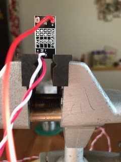

To get the needed 12V for the soundcard amplifier I used a
step-up voltage transformer. It can boost the voltage from the
available lower 5V to exactly 12V. I ordered the circuit at
ebay for less than 3,00 EUR.
17.92 KiB
993 views
The Terratec Card was about 10,00 EUR.
I used the standard 2-pin fan connector near the PCI port. Then I soldered the 12V output wire to the riser card.
That way I did not need to solder directly to the mainboard. Who knows if this would be useful anytime.

Thank you very much. Prez helped out alot as he figured out that the Futro doesn't have the required 12v pci support and how to fix it.
I already noticed that the ESS Solo has a wavetable connector. I found a dream blaster s2 daughterboard at
https://www.serdashop.com/waveblaster
It says it is compatible with most soundcards and it seems to be tiny enough to fit into the futro. i will check if the necessary space is available.
