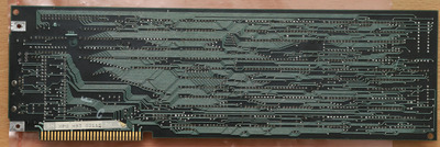

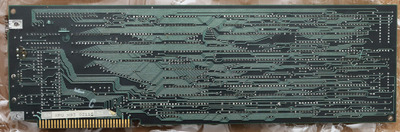

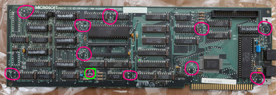

Dont have time to start this project now but would like to prepare: Does anybody own this card? Mine is missing some components. Maybe its possibble to guess the caps but for the "Q1" (red-green circle) I have no idea what to put in?

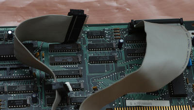

I think the cable can also be assembled from an IDE-cable and a socket. Pinout should be clear after identifying GND and VCC.
Already got the 8086 from China and found a reference photo, but I cannot read any value.
Thanks!

Reply 5 of 46, by therevisiona
Predator99 wrote on 2020-05-15, 19:12:
derSammler wrote on 2020-05-15, 12:01:
Q1 is a simple pnp transistor.
Thanks! There are different types to choose from - what characteristics are important?
A standart NTE159M should do the trick

Reply 14 of 46, by Predator99
therevisiona wrote on 2020-05-15, 19:15:
I will try this one, hope this works?
https://www.ebay.de/itm/2N3906-Transistor-PNP … ar=571685246606
2N3906 Transistor PNP TO-92 200mA 40V
Thanks for the discussion. Hope I get it running and can report...

Yup, should work

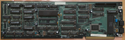

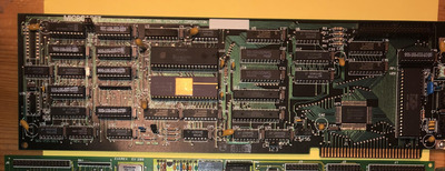

I made some progress and soldered the missing parts:
810.71 KiB
2510 views
1021.96 KiB
2510 views
I put the card on a XT-board and it does...nothing. Thats a good sign 😉

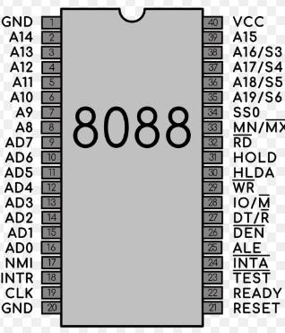

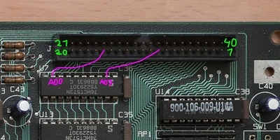

The interesting question is now about the pinout of the CPU-connector cable. I have read that this is a 1:1 connector. My proposal is the following pinout to the 8088 (green):
188.59 KiB
2510 views
I already verified that Pin 1 and Pin 20 on my drawing are connected to GND.
Then it seems to match that the inputs of the 14HCT573 (D0-D7) below the connector are connected to Pins 9 - 16 (AD0-AD7). (purple)
24.47 KiB
2510 views
Can I do any more meaningful measurement to verify my proposal? But I think it should be safe to connect it as proposed...?
I am going to use a IDE-cable first.
494.68 KiB
2510 views
When it works I will order a connector:
https://www.jameco.com/z/8200-40-R-Connector- … Pins_42712.html
I think my cable is OK and I tried to switch on - but nothing. Could have been worser as there is no short and nothing exploded 😉
I think a reason could be thjat I tried in a Turbo-XT board:
https://arvutimuuseum.ee/th99/m/C-D/30052.htm
I noticed that the Turbo-LED is on after powerup, regardless the Turbo-switch setting. That means the CPU is running at 10 MHz which is too much for the MACH-10. Think I need to take a look if I have a real 4.77 MHz XT-baord...
