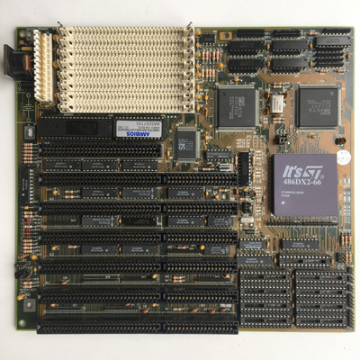

Reply 26 of 30, by andunn
Try the attached BIOS image, I dumped it from my non-working board. Looks exactly the same as your one, although mine is missing the correct KBC. Not sure if that is what prevents it from booting, might be something else broken as I got it in a non-tested state.

Reply 27 of 30, by computerguy08
andunn wrote on 2021-09-08, 11:31:
Could you take a photo of your board ?
There are multiple versions of the SY-020: http://www.win3x.org/uh19/motherboards/?showI … s=1&name=SY-020

Reply 29 of 30, by andunn
The board I have is either a SY-020M or SY-020P. Can't tell for sure as the model number sticker is missing. I've attached a hi-res photo of it.
