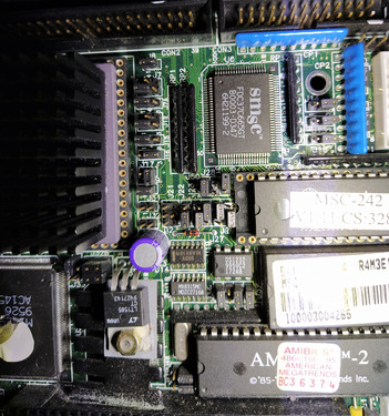

Here is my jumper config.
Starting at "conn2" next to the cpu going down:
J8: on
J7: 1-2
J7A: 1-2
J12: 1-2
J15: 1-2
J16: 2-3
J17: off
J19: off
J31: off
J32: off
Between CPU and vrm sink:
J33: 1-2 (select 3,3v or 5v)
J32B: 3-5; 4-6 (+3.3v power input connector?)
Com CPU to Dallas clock:
J21: off
J22: 2-3
J23: 2-3
J24: 2-3
J25: 1-2
J27 : 1-2
J29: 2-3
(above that)
J50: on
J28: off
J26: off
(Down to Dallas)
J34: on
J35: off
J36: on
J37: on
Next to bios:
J47: 2-3
J48: 2-3
Next to buzzer:
J6: external pc speaker
J10: keyboard diagnostic header
J11: keylock
Cnp1: PC/104 connector (as you described)
(Towards smsc chip)
J14: 2-3
J13: 2-3
J18: 2-3
At corner between ISA edge and ps/2:
J42: (white 5pin connector)
J45: 1-2
At corner between ISA edge and mem slot:
J43: 1-2
J44: 1-2
Mem slots: 72pin simm, max 64MB

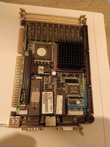

Reply 4 of 15, by waterbeesje
So I've acquired a backplane. Put the board on it, with a Video7 Cirrus GD542x (not sure what it is, there's a big V7 label on it) and a 64MB compactflash card. 2x 4MB FPM 69ns ram sticks should be enough for now.
It's alive!!!
I managed to set all settings to lowest timings in the bios setup and it turns out to be pretty fast! But that's for another thread.
So far it seems the jumper settings mentioned above will do for an Intel DX2-66 CPU, even WB L1 cache can be enabled in bios settings. My CPU doesn't like that though...
Even more jumper settings are incomplete, it would be nice to add in UH19 I think 😀
Would this pic do?

    better pic
Stuck at 10MHz...

Reply 6 of 15, by waterbeesje
And again a beter pic. This time without the ram/mem. Less shadows, more detail on silk screen. I'll get into the jumper/component drawing, that's not so hard 😀

Reply 14 of 15, by chaozz
waterbeesje wrote on 2020-06-02, 10:05:
Yesterday I collected some interesting stuff. This included a Mitac MSC-242 industrial processor board. The seller told me it was a working system pull about 8 years ago, so it should work. It's got a DX/2-66 installed according to a sticker on the bottom of the processor. And a Dallas clock of course, probably dead.
I just acquired the same board and was struggling to get it working. No matter what hardware I used, I got nothing on my monitor. That is when I found this topic and this photo.
I used the photo to set my jumpers. I installed a 486DX2, some 72pin memory and a VGA card. After I set the jumpers I still got nothing. I then swapped the memory for a different 72pin stick and then it started to do stuff. I got 8 short beeps, which means an error with the graphical memory. I swapped the VGA card for a different ISA card and it sprung to life!
A few things I learned getting this to work:
  • The jumper settings in the first post work for me
  • You need to properly push down the CPU in the socket
  • Try other memory when you get nothing on screen
Bizarrely, when I checked the bios yesterday it said 1st of April 2023, so the DALLAS clock was still working fine!
I found a datasheet for the MSC-242 which I added to my post as well as the ISA backplane that I used to get it all working. Hope it helps someone.
