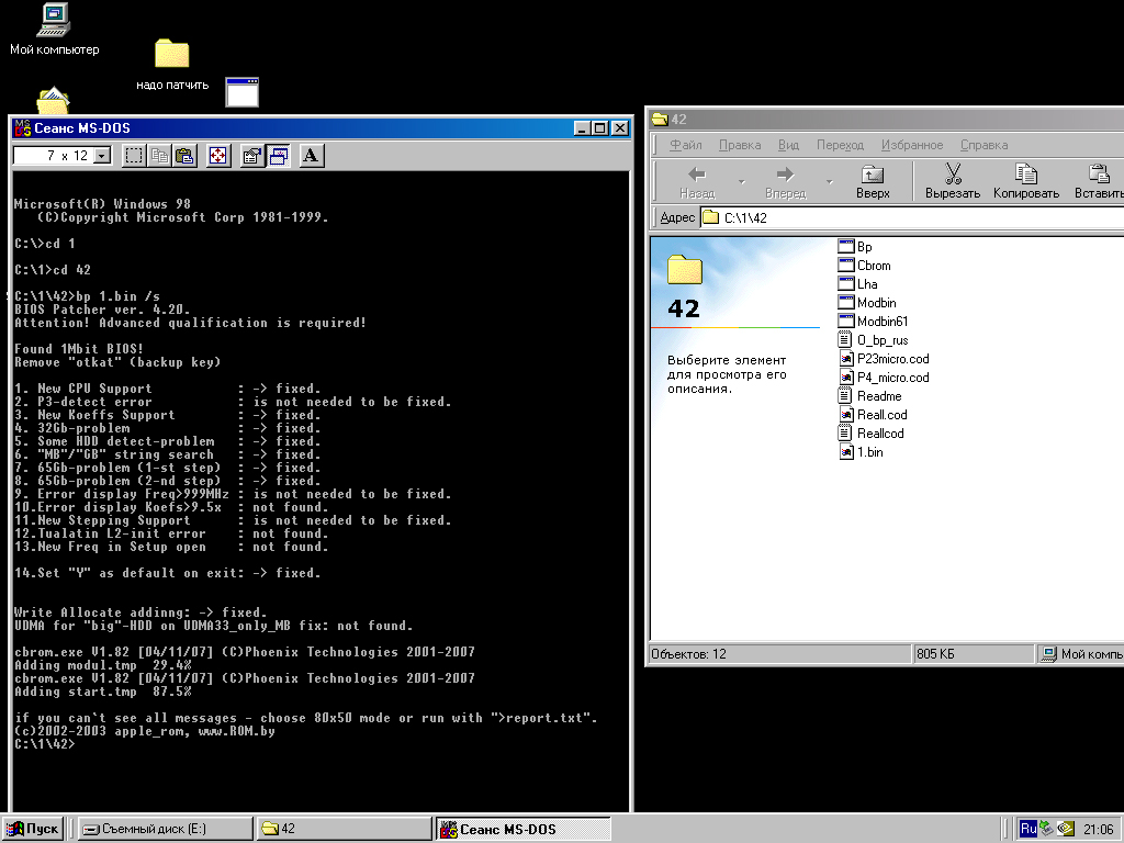

Try ROM.BY BIOS Patcher.
http://www.rom.by/articles/BP/index_english.htm
http://www.rom.by/Award/patcher/BP-6a9.rar
or http://www.rom.by/Award/patcher/BP-4_51_beta.rar
or http://www.rom.by/Award/patcher/bp-4_23.rar
(also need http://www.rom.by/Award/patcher/lha.rar and http://www.rom.by/Award/patcher/cbrom.zip for work)
Sadly, but most of documentation for it is in Russian (the Patcher self have English interface however). Google Translate should help.
What it can do:
bezymjannyj-jpg.157132
Don't forget to prepare a backup and ways to flash the correct BIOS back! The Patcher sometimes easily bricks some boards. It was not completely debugged and some versions have bugs that breaking some BIOSes. If v4.23 does not working, v6.0 may be useful, and back.

If you don't have an EEPROM programmer or a second board set up, you can hotflash in the same board if you have a spare BIOS chip . Just boot from a good working BIOS chip, swap in the BIOS chip you will use for testing and flash that .
That way you always have a fallback to your good BIOS chip . Obviously, hotflashing is not 100% risk-free (accidentally shorting something is an example of such a risk), so I would still recommend you get an external programmer .
