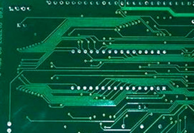

Reply 16 of 20, by majestyk
The DIL32 socket was only used / populated, when the chip was supposed to be replacable by the end user without soldering. Per default the BIOS is stored in the (square) flash-ROM that´s located right of the DIL socket.
So all 2940UW without a DIL socket do have their own SCSI BIOS. You can verify this when you look at the traces on the backside:
97.55 KiB
1490 views
Reply 17 of 20, by zyga64
I don't know, so I will comment 😀
Maybe 2940U2W (80MB/s) will be better choice ?
I remember that even AHA-29160 (64bit PCI) works just fine in 32bit slot (however AFAIR it was later machine - P4 or Core2 based, I'm not sure about Pentium Pro).

Reply 19 of 20, by aureal
majestyk wrote on 2022-07-31, 08:24:
Thanks I did indeed confuse the dil socket for the bios socket. Thats great to hear that is not the case because the 2940UW is a lot easier to find for me.
