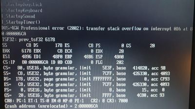

Reply 26 of 49, by drunkenlizard
Hi, I got the N600c with Win98SE after reading on a thread here that it might be an "ideal retro gaming laptop", and found it for cheap on ebay. I've been troubleshooting, trying to get audio to work in DOS games for 2 days straight, and have nothing to show for it.
I have tried every fix related to this topic I could find. I finally came upon HandOfFate's instructions here. Followed them carefully. Still nothing. I've tried running Doom and Ultima Underworld. Doom runs only from an MS-DOS prompt in Win98, and without audio. If I run it by directly booting into DOS, I get the error in the attached image.
Ultima Underworld runs fine, but no audio, and I have to give it more EMS memory in CONFIG.SYS to run it. Yet Doom requires NOEMS or else it tells me "not enough memory". I'm not that computer-savvy (compared to the average user here I guess) and don't understand the significance of this.
Also, the mouse doesn't work in pure DOS, but I didn't even begin to look into that issue. Nor do I really care at this point, as I'm burnt out trying to get anything to work with this laptop.

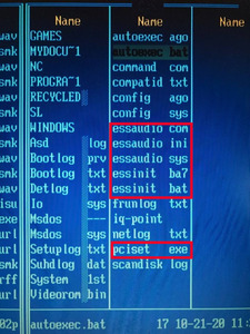

Reply 28 of 49, by vorob
The first step will be lazy, here is how it looks on my side (it was some time ago, so I'm just copypasting stuff):
I assume you've done what HandOfFate Re: Compaq N600c: hangs on playing audio in DOS, music works
Install WDM drivers (via SP18965.EXE or any other)
Then you've copied all files from his pack into c:\
Here how it looks on my pc:

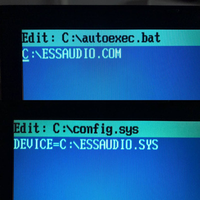

And here is the content of two system files:
196.24 KiB
2154 views
I guess you need to correct it in Windows, not write directly in the file.
Then I just go into Command Prompt in win 98 launch menu and run ESSINIT.BAT, after that, I've got sound in native dos.
