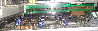

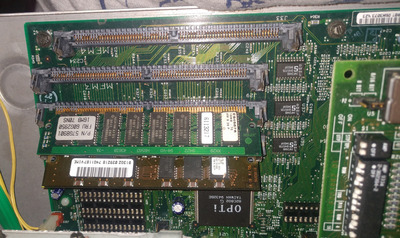

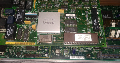

Reply 5 of 7, by Cobra42898
theres a printed tag on the MB, does that help further identify this machine?
also looks like video ram and cache slots are empty, ill have to see what options I have there.
Searching for Epson Actiontower 3000 486 PC.
Reply 6 of 7, by chinny22
Info seems to be pretty thin on motherboard specifics but all signs point to 3.3v only
https://psref.lenovo.com/syspool/Sys/PDF/with … book/vpbook.pdf
Cache chips are usually easy to buy, Video is a pain. You need to match the ram type (Looks to be DRAM in this case) and only source these days is pulling off other video cards.
Most likely you wont miss it on a dos gaming PC. Only time you would have needed it is to run the windows desktop at higher res/colour depth
http://www.danielsevo.com/bocg/bocg_screenres.htm

As for cache and video, I'd say the exact opposite of chinny: VGA is simple, cache can be a headache.
Those chips are invariably 4Mb (512kB) SOJ DRAM chips, and can indeed be harvested from just about any PCI video card, so long as the latency (last digit after the dash on the chip) is at most equal to the existing chips. Given that the 864 was one of the first to use SOJ chips, pretty much anything else will be rated faster so work fine. You won't notice any difference in DOS (the current 1MB onboard is more than enough for any VESA mode actually used by games), but in Windows it will increase resolution and/or colour depth - now you are limited to 1024x768 with 8bit colour (256) or 800x600 with 16bit colour (65k). With 2MB you could do 1024x768 with 16b colour or 800x600 with 24b colour (16.7M). In both cases I'd recommend 16b colour as the sweet spot, looking much better than 8b, but getting higher resolution than 24b.
Cache on the other hand means figuring out what config the board wants and how to set jumpers accordingly... the specs indicate you need 15ns SRAM DIPs with 256kb (32kB) per chip, but doesn't list organization or pin count. That said, adding cache to a cacheless system will seriously improve performance, so this is very much a recommended upgrade.
