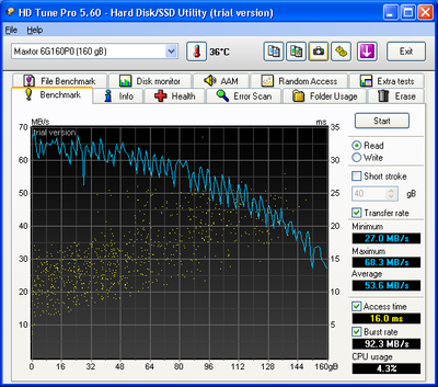

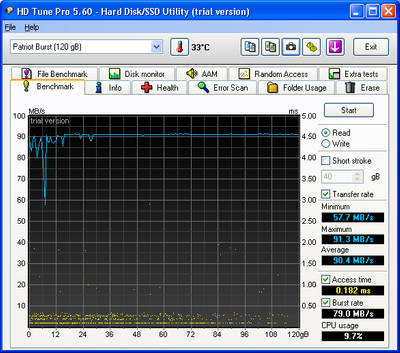

I will try another ssd but honestly I really think it is a no go. I tried to find a SinLoon pata-sata converter but apparently it's not sold on european amazon, my chinese adapter also transfer the smart values of the ssd.
Yesterday I also tried to benchmark the hdd and the sdd, it seems that the bottleneck is the sis eide controller:

What do you think?
Windows xp loads in 2 minutes, even if it's just installed... What do you think, Could I try the velociraptor hard drive? Maybe it will be a bit faster?
What do you think?
Considering that the ATA133 port you are using is probably limited by the PCI bus' MAX 133MB/sec total throughput (not counting overhead), your performance looks about right . It is in line with what I was getting with a PCI Promise Ultra133 with a Samsung ATA SSD (using a Jmicron chip).
My guess is your bottleneck is elsewhere, possibly CPU related . If you have a visible disk activity indicator, does it seem to stop flashing/being lit for periods of time during XP boot ? If it does, it coukd be a hint that points at CPU load .
Another thing to look at is services failing to start and having long tiemouts . A look in system event log should show if there are any such issues .
Reply 14 of 44, by The Serpent Rider
Integrated IDE ports are not connected to PCI bus.
Reply 15 of 44, by darry
The Serpent Rider wrote on 2020-09-10, 19:52:
You are quite right about that for the 962L southbridge at least (I was still thinking about PIIX).
There is likely a 533MB/sec link between north and south bridges on OP's board . SIS IDE implemention/design may have throughput issues, though

Reply 16 of 44, by darry
Apparently SIS962L IDE required software workarounds for optimal performance .
https://www.motherboardpoint.com/threads/shut … de-issue.33449/
Here is a link. https://download.shuttle.eu/Archive_2004/Driv … IS/SiSide41.zip
No idea if it applies to OP's specific setup .

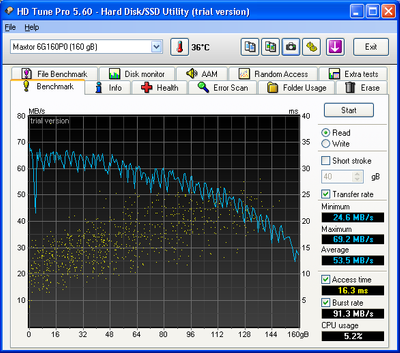

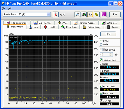

Reply 18 of 44, by Nemo1985
The driver adviced were the same as the one installed, I anyway took the chance to install them again, things aren't changed:
44.45 KiB
634 views
40.09 KiB
634 views
I can confirm that udma mode was enabled and it is still so, I really suspect that the sis ide controller just can't keep up, probably the Sis 962L is just a rebrand of 961 which supported ata-100.
Reply 19 of 44, by The Serpent Rider
I wouldn't jump to conclusion yet. Perhaps SSD is just that horrible at linear read/writes. Looks like Patriot low-end SSDs are quite bad performers for such capacity (no cache, bad NAND?).
962L was major upgrade, supporting USB 2.0 and Firewire.
