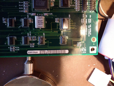

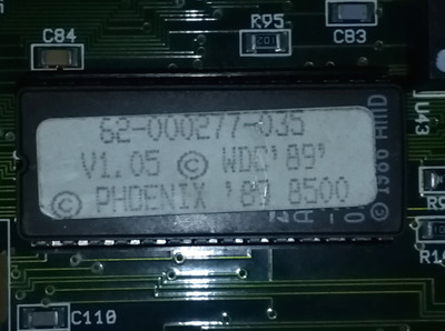

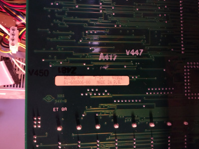

I would need some help to understand which motherboard is the one in the photos and then if someone helps me to understand the VGA output circuit, I would have identified a problem in the lm339D but I don't understand the circuit.
Color Palett IC
RED ----- m339D
GREEN -- m339D
BLUE ---- m339D

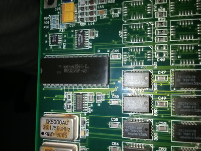

    IMSG176P-40

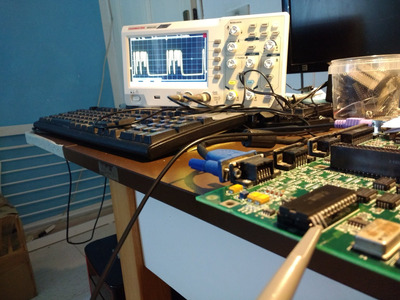

    signal ok - no connection to lm339d

    WD286-MIN

The LM339D is a quad comparator, so it contains four parts that each compare a voltage to a reference voltage. In you case, I guess the purpose of the LM339D is to find out whether a monitor is connected. A monitor pulls down R, G and B via its 75 Ohm termination resistor. If no monitor is connected, the R/G/B outputs rise above 1V. Grayscale VGA monitors possibly only connect G, so if "G" is OK, but R and G are open, you most likely have a B/W monitor.

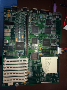

The motherboard is missing the video rom as well as the 2 bios chips. Can I assume you've found these chips and installed them? because the board isnt going to do jack without it. (to say nothing of the missing CPU)
I did find a similar motherboard, this one: https://stason.org/TULARC/pc/motherboards/W/W … -WD286-LPM.html LOOKS like a slightly earlier model compared to yours. The parts are mostly the same, just slightly moved around a bit.

Hi
The photos are during the test of the power supplies I had removed what was possible.
I also came to the conclusion that that motherboard was very similar to
WD286-LPM12
AT&T 286 -> https://forum.winworldpc.com/discussion/11026 … 286-take-a-look
PACKARD BELL 286-12 -> https://www.ebay.co.uk/itm/PACKARD-BELL-286-1 … 3-/303237070314
In a few hours I will be able to dump the bios and see if there is any more information

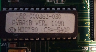

Bios dump say
"Setup (c) Copyright 1988 by Phoenix,WDC [WDC 11/30/89 2.10] Setup Ver 2.10 (c) Phoenix Technologies Ltd.,WDC
For Memorex Telex Intelligent Systems : : ,

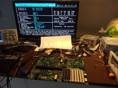

Is a good idea !!
Now that I managed to turn on the video, I just need to make it recognize the hard drives (some problems on the interface).
And I miss to understand why it only starts if it has 2 floppies connected (and the disk inserted in B)
