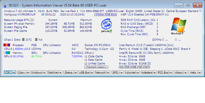

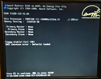

I have a dual-cpu Slot-1 Tyan S1834D Tiger 133 mainboard with Via 694X chipset. I just sucessfully modded MS6905 Master 2.3 slotket and booted that mainboard with one SL5XL Pentium IIIS 1400MHz CPU (didn't try dual-cpu setup yet, I need to get second slotket). I set voltage jumpers to 1.45V, I measured 1.54V on MOSFET tab next to the CPU slot, but I guess that's fine. (edit: that was next to the empty slot, working slot gets 1.47V under load, so that's perfect)
It POSTs just fine, but displays wrong multiplier. CPU is detected as PENTIUM III 1400MHz (215x6.5). There is no -S suffix.
Should I care about this? Do I lose anything by not having proper microcode in BIOS? I can't find a BIOS with Tualatin update for this motherboard. Are there any tools I can use to add the microcode by myself? Or does it require hex-editing the BIOS by hand? I have a programmer so i'm not worried about bricking the board.

adalbert wrote on 2020-11-14, 00:57:
I expect the raw multiplier in MSR 0x002A is 0x1F which is x10.5, but the BIOS is only looking at the low 4 bits as x6.5 is 0x0F. I further suspect the BIOS does not have code that knows about the CPUID 2 cache type 0x83 which is L2 512KB . I wonder what CPUID 80000002/3/4 return, it should be "Intel(R) Pentium(R) III CPU - S 1400MHz".
I could comment further if you posted the Menu->File->Save Local files from my SIV utility, ideally run SIV32X on Windows XP or later.

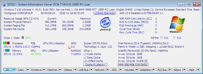

red-ray wrote on 2020-11-14, 15:24:
I attached saved files. I ran SIV32X on Windows 7.

Reply 5 of 21, by red-ray
adalbert wrote on 2020-11-14, 19:20:
Windows 7 is good. My initial thoughts were correct and as I suspected the name in CPUID 80000002/3/4 did not have the - S, I don't think this really matters.
The BIOS only detected 2 DIMMs, but looking at Menu->System->SMB Bus there look to be three DIMMs present. How many DIMMs are actually installed? I think there is a Golden Empire DIMM with some sort of issue.
SIV did not detect any SIO chip so no motherboard temperatures, fan speeds or voltages were reported. Do you know if the board has one/does the BIOS report these?

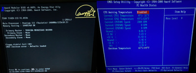

Reply 6 of 21, by adalbert
Thanks for checking the logs.
Yes, I had three DIMMs installed, and they were not detected correctly. First I tried populating 4 banks with 256MB modules (8 chips on each side of stick). With four modules BIOS detected 640MB? or so. With three it detected 512MB, and in such configuration I saved the logs. After that I removed all the memory, installed 2 x 256MB modules with 4 chips on each side and they are correctly detected as 512MB. Memory problems were mentioned in BIOS changelog, I should update to the newest BIOS and see how it behaves. But it still won't have Tualatin support.
BIOS reports both fan speed and temperature. It has W83977EF-AW chip.
Reply 7 of 21, by red-ray
adalbert wrote on 2020-11-14, 21:44:
OK about the DIMMs, let us know how things transpire.
Looking at the attached W83977EF-AW datasheet it does not do hardware monitoring, is there another Winbond chip?

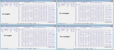

Thank you for the information and I suspect they are read via SMBus device [ 0_2D ], see Menu->System->SMB Bus. If you press [ 0_2D ] this should dump all the data and pressing [Timer] should update the data every few seconds. Do any values change as you plug/unplug fans and if so which ones?
I may be able to deduce what is what if you post a screen shot of what the BIOS reports so please do this.
I have adjusted the attached SIV32X 5.54 Tyan-01 test SIV so it should report Tyan S1834D (Tiger-133) and the BIOS version as V1.05, please may I have new save files so I can validate the changes.
It looks like Windows 7 loaded the CPU µCode 001C from mcupdate_GenuineIntel.dll so if not being in the BIOS is not a real issue. I suspect WXP would also do this.
Looking in the manual it specifies Supports up to 2 GB at 100 MHz and Supports up to 1.5 GB at 133 MHz so I suspect only three DIMM slots can be used with PC133 memory.

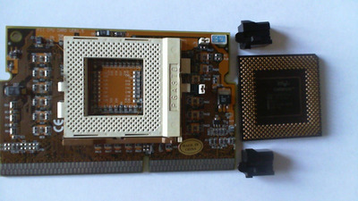

Update: I just found a PII CPU CARD VER1.5 + SL36C that I have not used for at least 15 years and I am wondering if it will work with a Tualatin CPU. The two jumpers are JP1 + JP2 and I have no idea what they are for.
    148.08 KiB
    1270 views
That slotket is built for Celeron Mendocino CPUs.
I found info about jumpers here: https://de.comp.hardware.cpu-mainboard.misc.n … d-ver1-5-jumper (google translate)
JP1 stands for the FSB, open 66MHz, closed overclock,
JP2 stands for dualprocessing, open none, closed dual.
It will not work out of box with Tualatin CPUs, also probably not with regular P3. S370 had 3 variants: PPGA, FC-PGA, FC-PGA2. Maybe it could be modded for Coppermine CPUs with PPGA -> FC-PGA mod. But the problem is that this adapter doesn't have voltage clamp chip. Coppermine and Tualatins use lower I/O voltage. I don't know if this is a real problem, there are mixed opinions. But your adapter also doesn't have jumpers for setting core voltage, and that would require additional mod not to fry the CPU.
I am using MS6905 Master slotket with voltage clamp chip. I insulated 3 pins in the socket: DYN_OE(AN3), RESET2#(AJ3), VttPWRGD(AK4). I connected VttPWRGD(AK4) on the CPU to VTT (AN11) with kynar wire. Similar mod should work with other slotkets which support Coppermine CPUs (they have that rectangural voltage clamp chip).
Here is some info about modding Mendocino slotket (like yours) for Coppermine, but I didn't try it: Re: Simple passive slotket on 694X dual cpu board for Coppermine/Tualatin?

POST screen and sensors page:
542.74 KiB
1125 views

This is how SMBus looks like with fan plugged and unplugged (i have a tiny 486 heatsink and fast fan right now, so it gets hot very fast):
