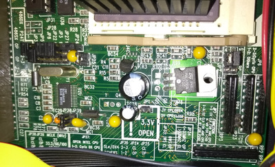

I want to try and push the voltage up on my 5x86 to get a stable overclock at 160MHz.
I assumed the TO-220 package on the board near the 3.3v/5v jumper would be a voltage regulator but it isnt, its a TIP31C power transistor (3.3v is jumper open, 5v is jumper closed)
Changing the jumper does change the voltage on the emitter, and the voltage on the emitter is the same as the VCC in the socket.
I was trying to work out how I'd alter the voltage here, ideally without removing the working TIP31C.
I was wondering (slightly optimistically!) if adding resistor(s) across the jumper would affect the output voltage - it does if there is no load (adding ~40 ohms raises the voltage to about 3.8v) but as soon as you put a CPU in, the voltage locks to 3.35v as though the jumper was open. I faffed about with various resistances to see if it made any difference - increasing the resistance did increase the voltage without a cpu load, but as soon as the CPU was in it locked to a stable 3.35v.
My electronics knoweldge is fairly limited - I'd appreciate some advice! Is there a sane way of adjusting the voltage or do I just have to live with it?

Reply 1 of 11, by quicknick
Should be possible, but not by altering the jumper as I suspect the only thing it does is to short out the series transistor when set to 5 volts.
I think you will have to play with some resistors that bias the base of the TIP31C, or it could be something more complicated using a voltage reference. Please post a close-up photo of the transistor and the area surrounding it.
Reply 2 of 11, by squelch41
quicknick wrote on 2020-11-22, 20:36:
Attached, thanks

Reply 3 of 11, by quicknick
Seems there's a LM431 involved, so I feel that's a bit over my head. But check its datasheet and try to trace out the schematic, find out the two resistors connected to the Ref pin - with a little effort you can replace one of them with a variable resistor and obtain a wide range of voltages...

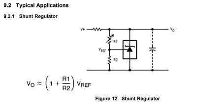

Okay, here's the relevant bit from the datasheet:
23.28 KiB
110 views
Vref is a fixed 2.5V. I think R5 (1.2Kohm) and R15 (3Kohm) from your board correspond to R1 and R2 on the above schematic. If I'm right, replacing R5 with a 1.5Kohm will yield a voltage of around 3.75V, or 4 volts when using 1.8Kohm. Or replace it with a 3.3Kohm multi-turn trimpot and dial-in any voltage from an useless 2.5V up to (almost) full 5V.

Reply 10 of 11, by squelch41
quicknick wrote on 2020-11-24, 00:22:
Okay, here's the relevant bit from the datasheet: LM431.jpg Vref is a fixed 2.5V. I think R5 (1.2Kohm) and R15 (3Kohm) from your […]
Of course there's a chance I'm wrong and your board will go up in flames, that's why I suggested you to study the datasheet and trace the connections around the LM431 😉
Thanks - I was a bit confused about which circuit on the data sheet was the correct one to follow (No engineering training, as I am sure is obvious!!)
I was thinking R5 and R15 were the voltage dividers too.
There is 0 ohms between the Vref pin of the LM485 and one end of R5 and also of R15
Referenced to ground:
The ouput from the LM485 cathode is 4.1v and that is the same voltage as is fed to the TIP31C base (4.75v is on the collector == power supply output on the 5v line; 3.4v on the emitter)
Voltages on the Vref pin of the LM485 is 2.45v
on R5, on the side wired directly to the LM485 is 2.45v and the other side is 3.4v
R15 is 2.45v on the LM485 side and 0v on the other side
So that is all as it should be if those are the voltage dividers shown in the data sheet diagram I think?
Also, then if, as a test, I piggybacked a 15k resistor over the 3k resistor, that should give a resistance of 2.5k and a voltage output from the the TIP31C of 3.7v?
