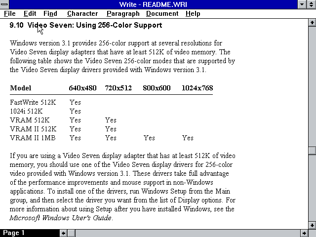

Also, if all you want is 800x600x256, then there's more choices, eg. Video Seven:
9.85 KiB
2584 views

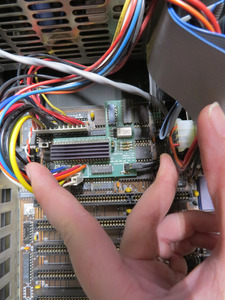

Reply 13 of 62, by AngieAndretti

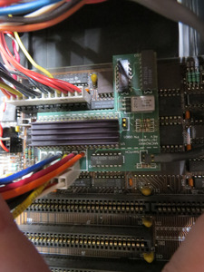

Here are a couple shots of the MicroWay 287Turbo.

Reply 15 of 62, by Anonymous Coward
That 287Turbo module is pretty insane. I have a 287 upgrade module of some sort which allows the FPU to run async to the CPU, but it's very compact and simple...nothing at all like this monstrosity. Why on earth does it require so much power? Were they afraid that the original AT motherboard couldn't handle a 10MHz NMOS 287? Where does that two lead cable go?

Reply 16 of 62, by AngieAndretti
Anonymous Coward wrote on 2020-12-02, 01:08:
If you're speaking of the grey wire, it goes to a momentary push-button switch that's mounted into the back wall of the case. It's just labelled "switch" on the 287 PCB, but it seems to function as a system reset switch - at least that's what happens if I press it. It acts just like pressing CTRL+ALT+DEL, but still works even if the system is hung at such a low level that CTRL+ALT+DEL does nothing - which is handy because it allows the system to skip the LONG memory count that would occur with a full power-cycle.

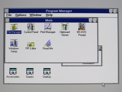

Reply 17 of 62, by AngieAndretti
Success with the Speedstar Pro graphics card in Windows!
The driver called "JWIN2224.ZIP" here: http://ftp.mpoli.fi/pub/hardware/DISPLAY/CIRRUS/ works! Description is "CL-GD5422/CL-GD5424 JWindows Display Drivers Version 1.41" but it works for my CL-GD5426 without screen corruption at 800x600x64k colors! Looks like "JWindows" refers to Japanese language (there were some unreadable characters in the driver description within Windows, but a quick edit to the .INF file fixed that.)
