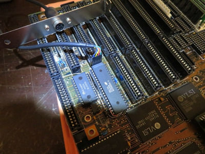

Reply 140 of 174, by feipoa

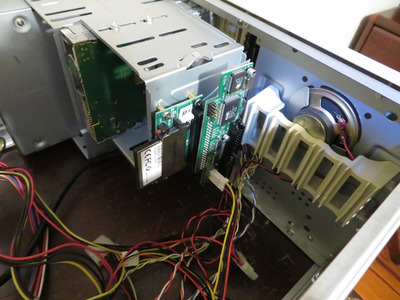

PHOTOS CONTINUED FROM PREVIOUS PAGE

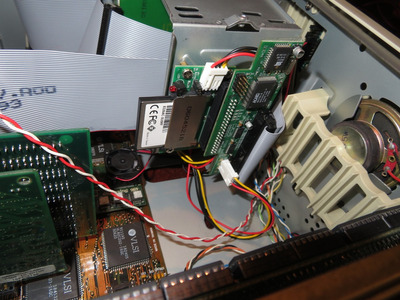

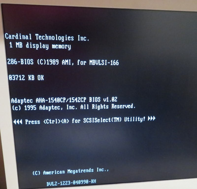

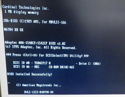

Showing the PS/2 adaption to the keyboard controller; how I mounted an internal CF-to-SCSI adapter; the BIOS memory count without the expansion card, but with shadowing enabled (3712 KB); the BIOS memory count with the expansion card, and with shadowing enabled (6784 KB) - note that some ISA I/O cards make it so that BIOS cannot see the expansion card. I didn't investigate further, but perhaps some port conflicts. Since I'm using the floppy port on the SCSI card, an general purpose I/O card wasn't of interest in the final design.

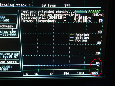

Reply 141 of 174, by feipoa

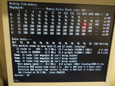

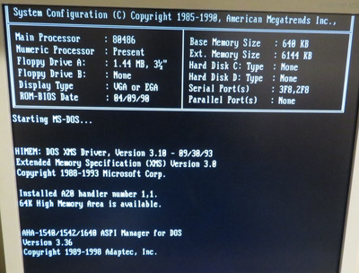

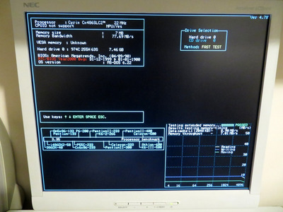

Image of the POST screen followed by Speedsys and cachechk screenshots showing the memory slowdown in the past 4096 KB address range. Doom also shows some slow down with the memory expansion card installed (from 7.19 fps to 6.79 fps). I'm guessing this slow down would be larger the more the program uses memory in the address range of the memory expansion card.

RayeR wrote on 2022-02-25, 18:26:
Hi, the memory card does really provide XMS?
I have similar one but it serves as EMS and standard p-mode games like Doom cannot use EMS.
The memory bandwidth is limited by ISA bus...
Yes, the memory card has settings (dip switches) for various conditions of memory allocation. You can set all the onboard memory up as XMS, as I have done, or you can setup part of the memory as EMS with two address control ports. This particular card should support LIM 4.0 EMS, which I've been told that the cheaper ones do not.

The cables couldn't have been neater because the ACARD was VERY particular about not being the last device on the SCSI bus. I tried various cables, terminators, and prayers. Sometimes it seemed like it would work as the final device, but next boot it would not. Some photos may show the ACARD as the final device, but that wasn't the final configuration. I also really wanted the CF card slot bracket to be on the outside of the case, but the length of the ACARD PCB prevented this. I'd have had to dangle the ACARD floating somewhere between the expansion cards, or create an extra long adapter cable to facilitate this. I did not want to bother. I also wanted to keep one slot bay open for the possible expansion of a second Everex memory card.

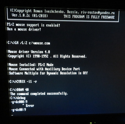

maxtherabbit wrote on 2022-02-07, 14:57:
Adaptec has a DMA test in ROM you can use to safely test the higher speeds without risking data corruption. Open DOS DEBUG and go:
g=c800:9
replace c800 with the base address of your ROM if different
It has been sitting like this for 15 minutes. Is this the expected behaviour? There's no HDD LED activity.
243.54 KiB
989 views
Reply 150 of 174, by maxtherabbit
feipoa wrote on 2022-02-26, 13:07:
g=c800:9
No, it should print some text about adaptec DMA test etc. and the activity light should be on
https://retrocmp.de/ctrl/llf/llf.htm
Bottom of this page shows what it should look like. It's possible the ISA cards with SCSISelect omitted this test routine from ROM. My only 154x SCSI adapters are the B revisions
Reply 151 of 174, by feipoa
I tried the debug command on my SXL2/ULSI-66 system which also contains the AHA-154xCP, but the result was the same. Perhaps the C adapters use different commands for this.

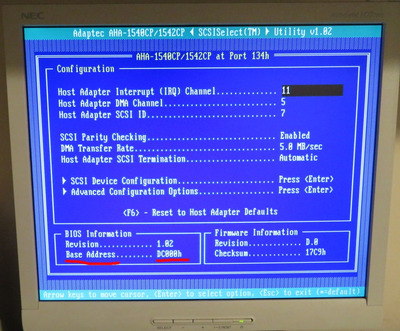

You sure about that base address? I see dc800 on the screen not c800
Reply 153 of 174, by feipoa

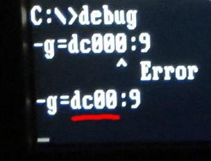

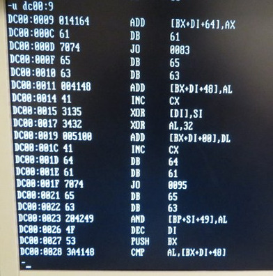

Maybe I misunderstood. Is this not the correct procedure:
213.42 KiB
942 views
15.87 KiB
942 views
Reply 154 of 174, by BitWrangler

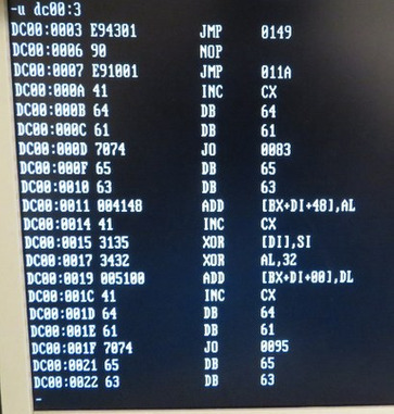

Oh right, I thought you typo-ed the example. Does it not like going to the top half of a segment or something and you've gotta supply base address of segment and it will look upwards, like D800 or something. IDK, I have to have a double espresso before I do memory math.
Reply 155 of 174, by RayeR
Just use debug with command
u dc00:0
to see if ROM is really there - it must start with bytes 55 AA
then disassemble again
u dc00:3
and you should see some JMP instruction that points to entry point of BIOS init code and
u dc00:9
should show JMP to diag code, if the offset is correct...

Reply 156 of 174, by maxtherabbit
feipoa wrote on 2022-02-28, 02:39:
It is correct. Your card simply must not have the test in ROM

RayeR wrote on 2022-02-28, 03:34:
Just use debug with command u dc00:0 to see if ROM is really there - it must start with bytes 55 AA then disassemble again u dc0 […]
u dc00:0
u dc00:3
u dc00:9
Does this look right to you?

Reply 158 of 174, by RayeR
.del.dupl.
Gigabyte GA-P67-DS3-B3, Core i7-2600K @4,5GHz, 8GB DDR3, 128GB SSD, GTX970(GF7900GT), SB Audigy + YMF724F + DreamBlaster combo + LPC2ISA
Reply 159 of 174, by RayeR
RayeR wrote on 2022-02-28, 12:48:
ROM is there 😀
It looks that the correct entrypoint is DC00:7 not DC00:9 so try
-g dc00:7
