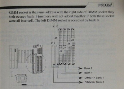

Reply 36 of 67, by Sphere478
the 256mb stick worked fine but when putting in that 128mb stick it didn't like it so I need to find more ram to try
I also ran across this
so it seems there are three banks
zero the left dimm
one the right dimm and left two simms
two the right two simms
I'm wondering how it would like 128 in dimm 0, 128 in dimm 1 and 128 (2x64) in simm bank 2
alternately, if 256mb works in one bank then maybe 256mb will work in all three banks for a total of 768mb?
it was said by someone that the 128 was a iffy pick cause of the chips it used. I need one with the correct chips

Reply 37 of 67, by Sphere478
Should I try edo dimms for any reason?
I ordered another one of these
If I install simms in the last two simm slots will it over volt the sd ram or will it be okay?
Should I have all slots as edo ram if I try three banks?
🖥Craziest socket 7 build on a 430tx chipset
🖥Dual socket 7 build
Reply 38 of 67, by pentiumspeed
Simple: Use BX chipset compatible 256MB SDRAM sticks. They are 16 chips type, low density.
Cheers,
Great Northern aka Canada.
Reply 39 of 67, by Sphere478
pentiumspeed wrote on 2021-01-27, 00:29:
Cheers,
how do I tell if it’s bx compatible
What do you think of the last few replies from me. Seems like I may be able to get 768?
