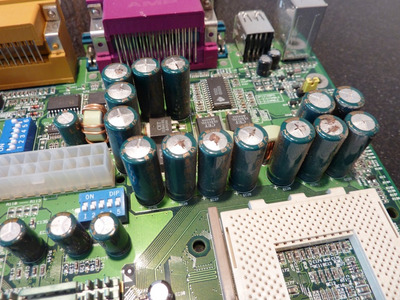

Hello,
I am trying to build an Athlon XP system that is as silent as possible. I recently bought a new EPoX EP-8RDA3I motherboard because the ASRock K7VT4A Pro that I bought in the early 2000s does not have a 12 volt connector and therefore requires a PSU with a 30+ amp 5 volt rail to work with something like an Athlon XP 2800+ . I have an Enermax power supply that delivers 30+ amps on the 5 volt rail but it is even noisier than the CPU fan. I hate having to hear that thing. So the hope was that I could just use my trusty silent 350w Seasonic SII power supply with the EPoX and be done with it. Things are not working great unfortunately. I suspect that this motherboard doesn't really use the P4 connector for the CPU but I can't be 100% sure. When I run burnK6 on FreeBSD to push the CPU to it's limits the machine just blacks out and reboots while the CPU temp is still at around 50 degrees. I have a 3ware 8006-2LP SATA hardware RAID controller in this machine and sometimes at boot the machine will freeze when loading this controller's add-on BIOS. And I also have random missing characters in Xorg. Before I go and buy another PSU such as a Corsair one with a 30 amp 5 volt rail that may or may not be silent enough, can anyone confirm that this motherboard does or does not use the P4 connector for the CPU?

Reply 2 of 12, by majestyk
First of all make sure all the capacitors in the voltage regulators for the CPU core supply are in perfect shape or have been replaced.
Sometimes Epox used Sanyo electrlytics which will probably still be o.k.. but maybe this is not the case here.
A picture would be useful!
Then you can check if there are still any instabilities. I doubt there will be any.

For some reason I thought that my Seasonic S12-II was 350w but it turns out it is 430 watts. A simulation of the power required by all components of this system came up with 330 watts but I suspect the hardware RAID card may draw more power than your average fake RAID add-on card. But 430 watts should be good enough. So I can probably rule out not having enough power.
Here are some photos of the system and motherboard:
https://cloud.metalpunks.info/s/zXwSsW2WyCNzpW6
This EPoX 8RDA3I was advertised as new never used. And indeed when I got it it looked like it was never out of the plastic. I don't know if capacitors still waste away when they never have been in use. I guess maybe it is in fact overheating and shutting down. Maybe that arctic cooling copper silent 3 fan is not good enough for an Athlon XP 2800+. Or this second hand CPU is worn out by previous intensive use and can't be pushed. I have another Athlon XP 2400+. I am going to try it and see how that goes.

Reply 5 of 12, by majestyk
dpirate wrote on 2021-01-23, 12:41:
They definitely do!
And you can see on pic. 18 that all 6 capacitors in the CPU VRM section (the ones in line besides the CPU socket) are defective.
(The 3 green Sanyo caps in front of them are probably still o.k.) I would also replace the one right besides the ATX PSU connector since it´s the same model as the other 6.
Replace them all and don´t power up the system in the current condition, it will hurt the CPU and other semiconductors.

Reply 6 of 12, by dpirate
majestyk wrote on 2021-01-23, 13:01:
(The 3 green Samsung/Samxon in front of them are peobably still o.k.) I would also replace the one right besides the ATX PSU connector since it´s the same model as the other 6.
Ok, I will put it aside until I'm able to change the capacitors. Thanks for taking a look.

Reply 8 of 12, by Repo Man11
I lost both my Epox 8K3a+ and my 8RDA3+ to bad capacitors. I presently have an 8KRA2+ that works well, but I had to recap it. I miss Epox, their motherboards worked very well for me.
Reply 9 of 12, by majestyk
This is how one of my Epox Socket A boards looked like after a few years of regular use :
207.01 KiB
594 views
But once these Epox bords from that era are properly recapped, they run "forever". The buid quality was top of the range, Epox became just another victim of the "capacitor plague" and got defunkt a couple of years later.
