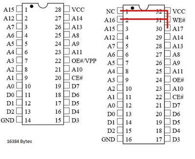

I have a couple of these cards and i plan to use one to boot off of compact flash on a 386SX.
I found the wiki page ( I think i was little too quick) and just ordered some AT28C64's which are 28 pin:
Boot ROM
This card's boot ROM socket takes a standard 32-pin EEPROM chip, as well as 28-pin EEPROM chips such as the 28C64. It has been tested extensively with the 28C64 chip flashed with XT-IDE BIOS images, both XT and AT versions. It is a reliable way to boot from a modern era hard drive connected to an XT or AT class system whose BIOS would not natively support it.
So im doubting if the socket just takes the 28 pin eeprom i have. Some pins are the same, but i have feeling i might need to create an adapter. I wish the statement went into a little more detail or had a link.
I dont want to plug them in until I figure it out.
I also wonder if it possible to write via the nic card. (I know about the eeprom writers)
Does anyone else have some experience with a setup like this and have any suggestions?

Reply 1 of 5, by Horun
I have very limited experience with these but if pre-programmed a 28c64 will replace a 27c64. You fit the ROM in socket like others with base at end leaving 1/2 and 31/32 open (for a 32 DIP socket).
Pin 30 in a 32 pin socket should also be VCC which will match up to pin 28 on DIP 28, what you do not get is the Write-Enable line since it is tied to A14 using DIP 28 so you must pre-program the EEPROM. That is all I know...

    32pin to 28pin
Reply 3 of 5, by Pickle
thanks, just knowing the pin alignment is a great help. Makes sense now why those are marked NC. I was wondering which had to line up right gnd or vcc.

Reply 5 of 5, by Pickle
so i ended up getting the TL866II plus programmer. Ive programed my 28C64B with the ide_386.bin. This should match my chip well at a size of 8 kb.
Ive padded the end with 0's. Ive tried the chip in 2 different 8/16 cards and in a 386 and 486 machine. I cant get it to boot at all.
The only option i really see is in the softset2.exe program to specify the boot rom address. There are quite a few options, but ive been going for D000.
All of the address ranges are 0x1FF in size. There is also an option for the rom program, but these appear to be old type programs so i dont think i need them.
I didnt think this would be that hard, but it still would be great to find someone who is using this card i this way.
Edit: I cant figure out why this wont work. Clearly the card is supporting 8k roms with the range of 0x200(0). I could actually see the xt bios data through umbinfo when the shadow ram was on. But seems like something on the card just doesnt work, see the xt bios data through umbinfo when the shadow ram was on. But seems like something on the card just doesnt work, even though networking with the packet driver has.even though networking with the packet driver has.
I checked the voltage on vpp, vcc lines and its 5 V. I even used a winbond flash chip and no change. I tried a second atmel chip no change. Tried 0x00's and 0xFF's for the alignment space.
Im going to get a 3com etherlink 3, since those seem to be popular.
Edit #2
Finally! I figured it out and it came down to the version of xt ide bios. The whole time i was trying to use the latest build v604. Went back to the v2 beta release and worked perfect. Now onto installing an OS and finally booting this thing.
