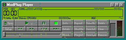

So the weird stuff start to happen when I put either 6200 (the G4MX440 never produce this problem). I get display pixel corruption on some application that seem to rely more on bitmap like you see in display property, icons, etc. It's like random pixel and a refresh usually make them disappear. TweakUI rebuild icons also repair it. It's random and most of the time it's OK. ModPlugPlayer seem to be very sensitive of it so I use it to test. I could took a screenshot and the corruption would be captured. So here's what it look:
5.4 KiB
110 views
If you click on a button that has corruption on it, it would disappear, but if you bring the window outside the screen boundary and bring it back, or shade it, there would appear unrelated pixels again.

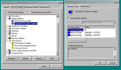

One weird thing I noted is that if I put the 6200 a second graphic adaptor appear that seem to be necessary and share the IRQ of the nvidia 6200:
20.44 KiB
110 views
I think the second device dont appear with the G4MX440. I dont find driver for it, and windows tend to go crazy when I try to for install 6200 drivers to it.

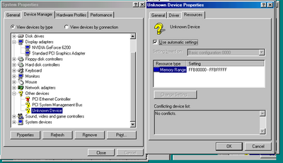

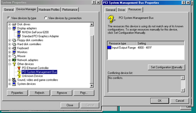

There is two motherboard device I can't find from this board. I'm not sure it's related but I'll post them anyway in case it can be of some interest:
