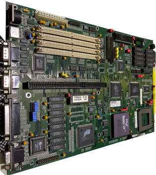

Jumper Settings
VGA Configuration - Jumper E1 (Shown in Green)
Function Jumper E1
VGA 2-3 5-6 Closed Enable VGA
Enable/Disable 2-3 Open 4-5 Closed Disable VGA
T3/T2 Cycle 1-4 Closed T3 LDEV# sampling
1-4 Open T2 LDEV# sampling
TTL/3-State 8-9 Closed TTL LEDV# level
Level Signal 7-8 Closed 3-State LDEV# level
DAC/System/Local Bus Access 11-12 Closed DAC System Bus Access
10-11 Closed DAC Local Bus Access
VRAM Size 14-15 17-18 Closed 2Mb VRAM
14-15 16-17 Closed 1Mb VRAM
13-14 16-17 Closed 512Kb VRAM
Extension Monitor Identification 19-20 Closed or 20-21 Closed
VGA Mode Jumper E1 Refresh Rates
640 x 480 25-26 23-24 Closed 60Hz Non-Interlaced
25-26 22-23 Closed 72Hz Non-Interlaced
800 x 600 25-26 23-24 Closed 60Hz Non-Interlaced
26-27 22-23 Closed 56Hz Non-Interlaced
1024 x 768 23-24 26-27 Closed 43Hz Interlaced
1280 x 1024 23-24 26-27 Closed 43Hz interlaced
Super I/O Shunt - Jumper E2 (Shown in Pink)
C & T I/O Chip
Enable 1-2 Open
Disable 1-2 Closed
IRQ Select (731 only)
IRQ 5 3-5 Closed
IRQ 7 5-7 Closed
Type of I/O Chip
C & T 721 4-6 Closed
C & T 731 6-8 Closed
DMA Channel Select (731 only)
DRQ 6 9-11 Closed
DRQ 7 11-13 Closed
DMA ACK Select (731 only)
DACK 6 10-12 Closed
DACK7 12-14 Closed
Eprom/Flash Eprom Shunt - Jumper E3, E4, E10 & E11 (Shown in Blue)
E3 E4 E10 E11 Function
1-2 Closed 1 Meg Eprom/Flash Eprom
2-3 Closed 2 Meg Eprom/Flash Eprom
1-2 1-2 1-2 Closed Read Only
2-3 2-3 2-3 Closed Read/Write Mode
Local Bus IDE Configuration - Jumper E5 (Shown in Red)
Function Jumper E5
Enable Local-BUS IDE 3-5 Closed
Disable Local-BUS IDE 1-3 Closed
I/O Addr. 0B4H, 0B8H, 0BCH 2-4 Closed ADI2 Register Port Address
I/O Addr. 034H, 038H, 03CH 4-6 Closed ADI2 Register Port Address
486XX CPU 9-11 8-10 Closed Host CPU Mode
Reserved 7-9 10-12 Closed Host CPU Mode
Drive ID 30H 13-15 14-16 Closed Drive ID Selection
Drive ID 31H 13-15 16-18 Closed Drive ID Selection
Drive ID 32H 15-17 14-16 Closed Drive ID Selection
Drive ID 33H 15-17 16-18 Closed Drive ID Selection
Mouse Port - Jumper E6 (Shown in Brown)
Mouse Port Jumper E6
Disable Open
Enable 1-2 Close
CMOS RAM Shunt - Jumper E7 (Shown in Orange)
CMOS CLR Jumper E7
Normal Open
Clear 1-2 Closed
Colour/Mono Shunt - Jumper E8 (Shown in Dark Green)
Jumper E8
Mono 3-4 Closed
Colour 5-6 Closed
CPU Mode Shunt - Jumper E9 and E14 (Shown in Turquoise)
Socket U46 Socket U59 Jumper E9 Jumper E14
486SX None 2-3 Only 1-2 3-4 5-6
486DX/DX2 None 1-2 3-4 5-6 1-2 3-4 5-6
486SX 487SX 7-8 Only 2-3 Only
486SX/DX & 486DX2 ODPR486DX (1 - socket type) 8-9 Only 1-2 3-4 6-7
486SX/DX & 486DX2 ODP486 (2 - socket type) 7-8 Only 1-2 3-4 5-6
486SX/DX & 486DX2 Pentium ODP (1 - socket type) 8-9 Only 1-2 3-4 6-7
486SX/DX & 486DX2 Pentium ODP (2 - socket type) 7-8 Only 1-2 3-4 5-6
None ODP486DX (1 - socket type) 8-9 Only 1-2 3-4 6-7
None ODP486DX (2- socket type) 7-8 Only 1-2 3-4 5-6
None Pentium ODP (1 - socket type) 8-9 Only 1-2 3-4 6-7
None Pentium ODP (2 - socket type) 7-8 Only 1-2 3-4 5-6
System Clock Shunt (installed in U52) - Jumper E12 (Shown in Grey)
CPU Frequency Crystal Frequency Jumper E12
20 MHz 40 MHz 3-4 5-6 Closed
25 MHz 50 MHz 1-2 Closed
33 MHz 66 MHz 1-2 5-6 Closed
40 MHz 80 MHz 1-2 3-4 Closed
50 MHz 50 MHz 1-2 Closed
Cache - Jumper E13 (Shown in Purple)
Cache Jumper E13
0K All Open
64K 3-5 4-6 Closed
256K 1-3 2-4 7-8 9-10 11-12 Closed
Chipset Mode Shunt - Jumper E15 (Shown in Light Pink)
Function 1-2 3-4 5-6 7-8 9-10
Un-sync ready Close Open
Sync ready Open Close
Ext rdy Enable Close
Ext rdy Disable Open
Cache
Burst 3-2-2-2 Close
Burst 2-1-1-1 Open
0 Waitstate Close
1 Waitstate Open

Should it help someone else in the future I have created a motherboard diagram to go with the tables posted above.
    258.07 KiB
    26 views
    DT-Tornado 2 / Jac-Up3 board diagram
