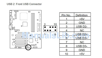

Long time lurker and apologies if this is the wrong place. I have recently rebuilt a windows 98se retro pc. All working great with updated usb drivers. My issue is my old gigabyte ga-7dx board only provides 2 usb v1 ports on the back and an on board usb pin out slot to attach some more. I would like to use the front USB ports on my atx case and the relatively new case I rehoused it in has usb 3 support and a cable that plugs into a usb 3 motherboard pin out slot, which doesn’t fit the old usb 1 pin out slot on my motherboard. Are there any internal adapters/ conversion products. I have considered adding a usb 2.0 pci card but they don’t appear to have a pin out slot on them for front usb connection. My only other alternative is I could use an extension cable and buy ps/2 mouse & keyboard to free the 2 USB ports up. Just wondered if anyone else has had this issue? I’m not trying to convert usb 1 to 3 in terms of standard/ speed (as that’s clearly not possible) I just want to have convenience of use 1 backwards compatibility on the front USB ports. Tia.

Reply 2 of 13, by MrBooble
It appears to be a 10 pin connection on the motherboard- but with 2 pins missing:
pin 1 is top left, bottom left is pin 2 and so on. So pin 3 and 8 is missing. The case connector is smaller.
Thanks I will have a look at the link you posted.

Reply 6 of 13, by MrBooble
weedeewee wrote on 2021-03-01, 13:50:
The pins on the side of the USB2 connector can easily be taken out of the plastic housing and put into the correct place for your motherboard.
https://www.amazon.com/Duttek-2-pack-Motherbo … 14606456&sr=8-3
ahh thank you so I could strip out the individual connectors from the front USB panel cable within the case and connect as follows....
Pin 1 +5V on motherboard -> USB+5v on stripped connector (top left pin in diagram)
Pin 2 GND -> GND (left 4th pin down)
Pin 3 USB D2- -> LP- (left 2nd pin down)
No Pin 4
Pin 5 USB D2+ -> LP+ (left 3rd pin down)
Pin 6 USB D3+ ->LP+ (right 3rd pin down)
No Pin 7
Pin 8 USB D3- -> LP- (right 2nd down)
Pin 9 GND -> GND (right 4th pin down)
Pin 10 +5V -> USB5+ (top right pin in diagram).
I'm assuming this would then work and the front USB panel will be a compatible USB 1.0 interface?

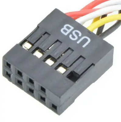

Reply 8 of 13, by weedeewee
Oetker. No need for any heatshrink, unless it's one of those 10 pin connectors with the 10th pin sealed completely shut.
Just carefully take out the pins that are in the wrong place, and shove'm into the right place of the connector.
MrBooble, yes, you just lift up the tab that holds the metal part inside the plastic part, pull on the cable to take it out, et voila.
and if it is on of those that just has the bottom sealed like the one in the photo, just make a hole in the bottom plastic.

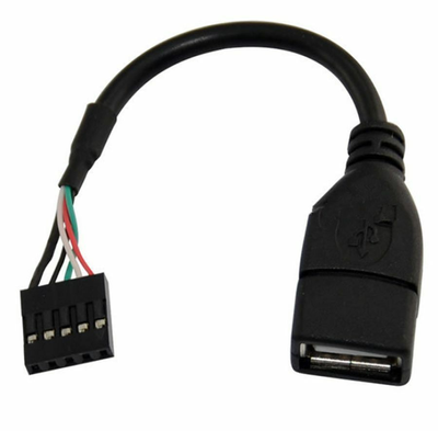

Reply 9 of 13, by MrBooble
Oetker wrote on 2021-03-01, 14:47:
I would put some heat shrink around the extracted connectors just to make sure they don't touch.
Could I re-purpose an existing adaptor and place the cable into the right place (re purpose an adaptor as shown in the pic). I'd need 2 of them for each usb port. This method instead of direct attached / with heat shrink? can you buy those 5 pin female adaptors on their own?
    215.48 KiB
    197 views
Reply 10 of 13, by MrBooble
weedeewee wrote on 2021-03-01, 14:51:
Oetker. No need for any heatshrink, unless it's one of those 10 pin connectors with the 10th pin sealed completely shut. […]
ah fantastic. yes I see, make hole where the 10th pin should be and insert. Yes that is a clean way of fixing the adaptor!
