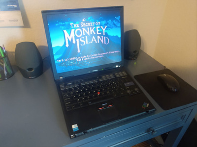

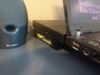

Reply 1 of 16, by fosterwj03
I don't know how easy these are to acquire in your neck of the woods, but I have a ThinkPad T42 paired with an IBM Dock II which can handle the tasks in your post pretty well.
I upgraded my T42 to a 2 GHz Pentium M processor and 768MB of RAM (it can go up to 2GB). My model also has a Mobile Radeon 9000 graphics engine that can handle most late-90s games at high resolutions with no problems (you might lose some DirectX 6 capabilities, though). My T42 has a DVD-ROM drive in the UltraBay and I upgraded the hard drive to a 128GB SSD using a mSATA to 44-pin IDE adapter/enclosure.
The Dock II adds a bunch of ports (USB, DVI, 2x PS/2, etc.) and expansion options (I added a floppy drive to the UltraBay). You can use the Dock II with an external monitor (the Radeon supports high resolutions including 1080p) and keyboard/mouse if you want to set the unit away from your desk.
The best part of the Dock II is the full height, half length PCI slot inside to dock. I put an Aureal Vortex in the slot to add 3-D audio support. Because the T42 has an Intel ICH5-based chipset, the Vortex also provides DOS SB Pro compatibility for DOS gaming. My Vortex also has a Wave Blaster header, so I can attach my Dreamblaster S2 for some sweet MIDI sounds.
On the downside, the Dock II adds a bit more space to the setup (about 11 inches behind the laptop). It's not a big deal if you use the T42's screen (it looks great, BTW) and keyboard, but the combination is almost as big as a thin desktop case if you use an external monitor and keyboard.
The power supply fan in the Dock II is also extremely loud. You could replace the fan with something quieter, but the Dock II is really hard to disassemble (I broke a Dock II trying to get inside to fix it).
As for cost, I've spent about $200 US for all of the parts (including the T42 and Dock II themselves). I'm really happy with how it turned out as a Retro PC. Here's a pic of some DOS gaming.
