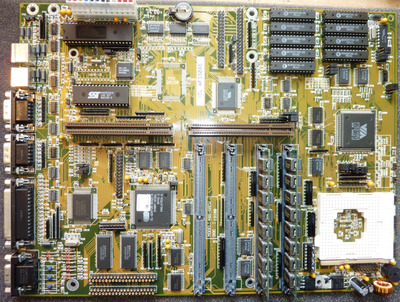

I recently got this nice LPX board and it´s one of the versions that had been stripped of some additional components / features probably because the company they prtoduced it for demanded a cheaper version.
So I decided to fill the empty places. This is the original situation:

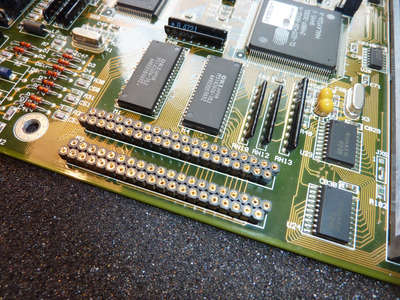

First I added the sockets for the additional 1MB Zig-Zag video RAM
1.66 MiB

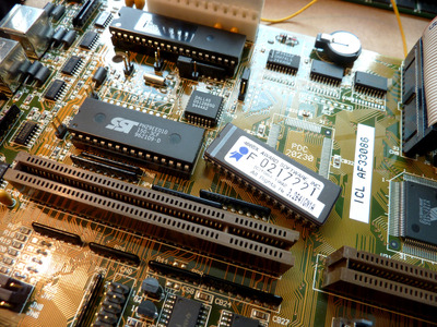

then the EPROM Bios was replaced by a Flash-ROM so the latest BIOS could be installed easily

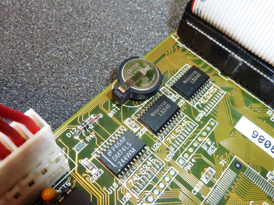

the original soldered Lithium cell was dead and the new one is now sitting in a battery holder

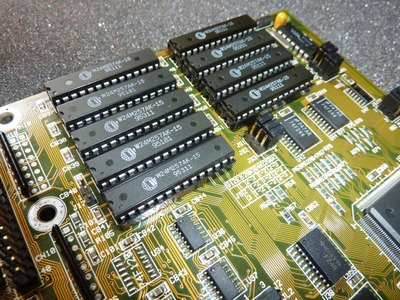

missing cache chips had to be fitted in
1.68 MiB

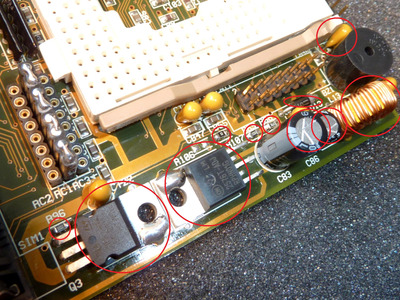

To make this complete the onboard VRM circuit components had to be soldered in place
Reply 1 of 11, by majestyk

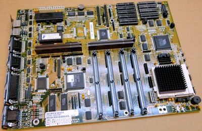

There are the typical components involved here. In the second piture I marked the additional components that had been missing.

With the new BIOS all Intel and AMD DX4 and Cyrix CPUs can be used. I will try an AMD DX5 - 133 MHz next week. I hope to also have the two video RAM chips available until then.

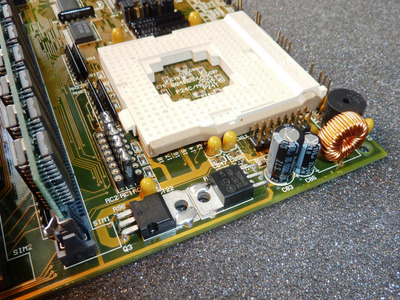

Here´s an overview of the board in it´s current state:
1.77 MiB
367 views
Several limitations have been solved, I wish I had the original ISA-VLB riser card for this mainboard to be able add a network card or VLB graphics.

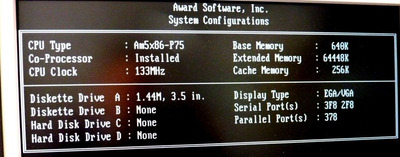

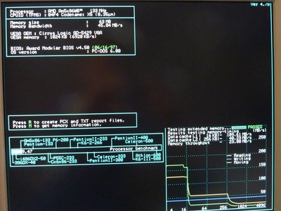

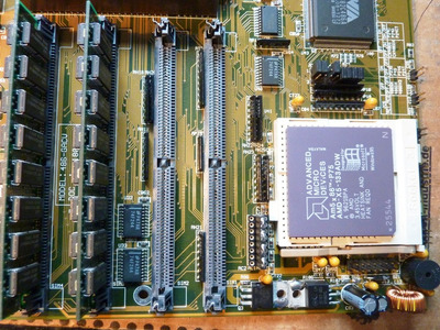

Today I equipped this 486-GACV with a AMD "X5-133AWD":
257.88 KiB
312 views
Double RAS SIMMS must to be placed in slots "SIM3" and "SIM4" here.
You can also see the jumpering here: Array RC1 must be populated, jumper "JC6" needs to be set to "2-3" (multi x2) to operate at 4 x 33 MHz.
BIOS version "3276 gn1" supports and correctly identifies this processor unlike earlier versions. Write Back L1 cache is enabled correctly.

Reply 5 of 11, by majestyk
It´s all in this thread.
You can see all the general jumpering on my "8GACV.jpg" picture above.
The complete jumpering for the AM5x86 - 133 CPU can be seen in picture "GACV133.jpg" above.
The output voltage of the VRM circuit is determined by the resistors R68 and R69 alone. For R69 = 2K and R68 = 3.6K you get around 3.4V output.
In the datasheet for the "2576T-ADJ" you find the formula for calculating the resistors for any alternative voltage in case you need it.
And don´t forget to flash the latest BIOS version "3276 gn1" for AM5x86 for enabling write back L1 cache.

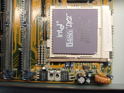

The BIOS, I already flashed the last one, but the CPU isn't always correctly detected, even with the original. It have a Intel DX4 66, but most of the times it is detected as "Unknown 60Mhz", 75 or even 80. I don't know what is the issue with that...
Reply 8 of 11, by carlosjor
Sorry, It is a Intel DX2 66. The board/bios don't detect it most of the time, and is 100% as it should be configured... A friend said something about a cristal not working right, but I'm in the dark about that...
I have access to the same CPU you have, I'll give that a try this next week...
Reply 9 of 11, by majestyk
Both DX2 / 66 and AM5x86 / 133 need 33MHz oscillator frequency. Ii is set by jumpers JK1-JK4. If the frequency is unstable (with the 5x86 as well) the oscillator circuit or the crystal could be the culprit.
You will also need the jumper array "RC1" that isn´t needed for DX2. Sometimes it´s missing if the booard was originally equipped with a DX CPU.

The R68 and R69, do you mean R66 and R69? Those are the ones on the VRM area...
And I have a jumper in CN11, I see ypu have headers but no jumper...
