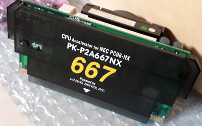

Reply 4 of 17, by PARKE
Stevogamer wrote on 2021-03-31, 20:35:
Apparently a company called IO-Data also made similar adapters although I haven't seen any for sale.
Yes, they produced a range of Celeron adapters: PPGA 466/500/533 & FCPGA 566/667/733
Here is a recent offer for one:
https://page.auctions.yahoo.co.jp/jp/auction/k1020547890
And a photo example of a later one that was, I believe, developed for NEC.
695.32 KiB
1239 views
