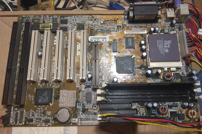

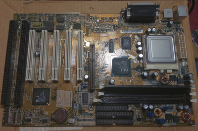

Hello fellow vogonians, my trials and tribulations with ss7 machines never end.
I have 2 Asus p5a boards same revision (rev 1.04) and same bios version, one bought as working which works fine with the IDT C6 cpus, while the other (bought as untested) apparently works fine with his stock cpu (K6-2 400) but when I use an IDT cpu (200, 225 or 240 doesn't matter) it reboots it self while benchmarking with quake.
What I tried so far without results:
1) switching from agp to pci video card
2) try another ram dimm
3) load the default bios settings and then use the very same settings on both boards.
4) caps are not bulging.
Any help with troubleshoot?
    1.98 MiB
    490 views
    Rebooting board
    1.99 MiB
    490 views
    Working board

Actually I have 3 idt cpus, my first try was to swap all of them on the non working motherboard (noone of them worked, obviously), then I used one on the other and it was working, after that I kept using the same for testing both motherboards since the cpu is confirmed working.
I swapped all the possible components, ram and video card.
I also checked the voltages on the bios, they are all in spec.
What is weird is that appparently anything else works fine, doom benchmark works fine, windows 98 works fine.
Swapping the bios didn't work, quake (640 or 320 doesn't matter) goes to the half of the benchmark and then reboots

Which spec exactly? Winchip C6 CPUs are designed to work at VRE (3.52V) not VS (3.3V) levels. What is VID0 set to? Should be 2-3 for one of these.
If it's already at 2-3, you could try bumping up Vio by setting VIO1 to 2-3 (3.6V).
That rules out firmware or settings and suggests that it's triggered when the Winchip's feeble litte FPU is heavily loaded. As the CPUs themselves work fine, that really does sound like a voltage issue. If it's not the level, it's probably the stability - although you'd need an oscilloscope to be able to troubleshoot that.
The cpu vcore is 3.5 while the vio is 3.5 too, I tried to raise it to 3.6 but nothing changed.
Also with the Winchip 2 even if uses the same settings works fine.
dionb wrote on 2021-06-08, 07:21:
Unlucky I do not have an oscilloscope, that stuff it's quite expensive.
What I noticed is that the pll chip become hot, I will later try the p5a which works with the c6 to check if that happens too.
Do you think a recap could solve the issue, despite che caps are ok to a visual inspection?
