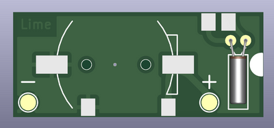

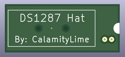

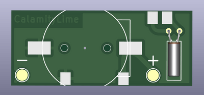

well, trying to make the most out of ordering from JLC I made a little board for those Dallas/odin RTC modules. I did finally get a socket 7 motherboard after all.
I know that Necroware made a replacement that uses a surface mount chip to completely replace the board but in my part of the world anyway, I find that the full dip packages are noticeably cheaper than the surface mount variants.
So I made this with the intention that the user can stick the PCB to the top of the dip and solder bent up legs of the dip to the board. Also included are test pads for the usual fix where you drill a hole in the side of the old RTC, I think sticking the board to the top and running wires will look cleaner. You can also sand down the stop of the old RTC if the added height is an issue.

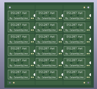

I done some tinkering with it to get so hopefully they are made right. KiKit is new to me and so is panelizing in general. So I spent most of the time making this just looking at specs on JLC and KiKits github page.
JLC seem to want the v-cut lines on the edge cuts layer, so that's messing with the kicad 3d preview a bit.

Talk to me about that bulk pcb pic. Do you just add edge cuts to that?

Reply 127 of 231, by CalamityLime
Hello
The panelled PCB was generated with kikit.
Score lines are added to the edge cuts layer which JLC said they want.
They have a page somewhere saying to use the edge cuts layer and i found someone else on a forum who used the default user comments layer and jlc didn't add the vcuts.

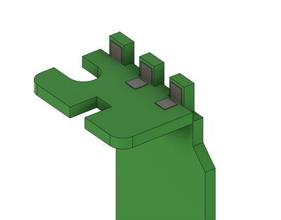

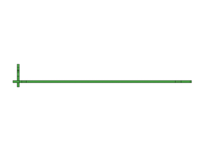

And you're surggesting that i make expansion slot covers out of pcb?
I have seen front plates made out of PCB before but i can't say I've seen an expansion cover made out of it.
Hmmm, I'll have a look into that, could be a fun way to make use of mouse bites.

Reply 129 of 231, by CalamityLime
animated Gif,
Pads didn't show up on it but it's just to show the shape so far.

You could probably make more of it solderable at the corners. Plated edges are in order I’d say. but yes, exactly perfect!
People could use these for missing brackets!
Add some braces to the side and a few holes for for the ports and I have a few cards that could benefit from this as a made or order bracket replacement.

Reply 131 of 231, by CalamityLime
Personally I would think that braces on the side would be too small to really get squared up right.
The PCB would have to be made at 1.2 mm thickness, expansion slot covers are usually around 1 - 1.3mm thick from what I've measured.
I've printed replacement brackets in the past and they work decently well. A big issue is treading for screws. Look at the expansion slot mount I made for the USB-2-232 for example, I had to work quite hard to avoid screwing into a thin spot while keeping the screw out of the way.

Reply 136 of 231, by CalamityLime
aye so I edited the pci slot cover a bit.
To show how I imagine the pieces being soldered together I exported the PCB model's and imported them into fusion. I added the pads roughly where they are on the PCB since the export doesn't include them.
My thinking is that the use lays down the large piece flat and holds the smaller one with tweezers while plopping a ball of solder onto the pads.
I attached the kicad files to the post. I'm not sure what else to do with them.
