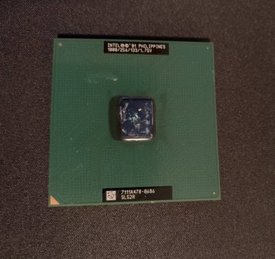

Got this in a box of parts... I thought cpus usually had a bigger metal surface on top, but this one only has this small square. Do I put thermal paste on the board itself too, or just that small bit in the center?

just the small bit in the center 😀
Besides even if you did cover the whole chip the green area wouldn't come into contact with the heatsink.
(Igot 2 of those chips and my advice is applied to them running nice and cool)

The large metal square you are referring to is called the Integrated Heat Spreader, or IHS. It is simply a flat metal piece that is covering the substrate (green) area and the actual CPU die (the small square).
There is a thermal interface material in-between the die and the IHS, sometimes solder sometimes a specialized thermal compound.
Regardless nearly ALL CPU's will look like the one you have pictured once the IHS is removed. This is called de-lidding. Some enthusiasts will do this in order to cool to bare die for overclocking.

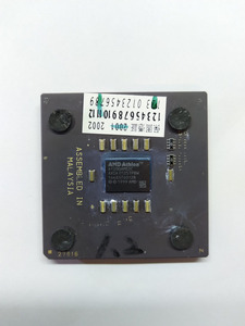

JustRob, this is a typical packaging of Socket 370 Coppermine Pentium 3 / Celeron and Socket 462 Athlon / Athlon XP / Duron / Sempron processors. Here's another example:
269.44 KiB
1097 views
Exposing the die can increase the rate of heat dissipation (by contacting the die directly to a heatsink) and reduce the amount of thermal paste needed, but can also increase the risk of chipping the die when installing a heatsink. AMD processors have soft pads at four corners (see the photo above) to reduce this risk but Intel processors have no such device, so be careful while lowering your heatsink onto that CPU.

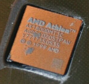

Got this CPU last week:
135.8 KiB
1089 views
Have a look at the bottom left corner.
No post, no beep.
But in that case I didn't care. It's a crap CPU anyway and came with a mainboard. I just wanted the mainboard. Got a small refund for the broken CPU, which is nice, because I don't have to sell it now.
Same thing happened to me in the past with old Socket 462 Athlons. Thermalpaste back in the day used to become super dry and hard. I did ruin 2 old Athlons when I removed the cooler.
Coppermines (like the one in your picture) are a bit more durable.
Some people these days even remove the heatspreader from modern CPUs, so they can put the cooler directly on the die.
It's called delidding. There are plenty of tutorials on Youtube.

seriusly its intel and all i see is a contaminated lid. The lids are basically impossible to remove from a socket 370 coppermine.
If it were an AMD it would be different.
Looks exactly like my ones they have lids like that too.
leave the lids alone geez 😀

I didn't damage it.
The seller damaged it, when he took off the cooler.
Just a reminder to be extremely careful when handling Socket 370/462 CPUs.

If by 'lid' you mean the heatspreader SL52R comes without one.

a chipped die like that doesn't necessarily mean the end of a CPU as long as it doesn't go too far, I remember my old Athlon C had a far larger chunk than that broken off the edge and it still worked just fine.

Yeah, exposed die, just like with Socket A Athlons.
Difference is just, that the glue (or whatever it is) around the die reachers further up and protects the corners/edges. That seems to help a lot, if I compare used Coppermines with used Athlons on Ebay. Most used Athlons have at least some minor damages to the die.
Indeed, there is a thin protective layer on the die. Depends on how deep the damage reaches.

Some years ago I was contemplating on whether it would be possible to disable part of the cache and make it work again if the chipped part of the CPU just happens to be that damaged cache.
Iirc I do remember that some of the bridges controlled the size of the CPU cache (with 256kb having a way to disable either half or 3/4th of the cache).
Seems like a not very useful hack for now (if it works), but perhaps for the future just ftr.

I don't believe it'd be simple as that, as there are probably many other lines routed around the outside of the die for connectivity
