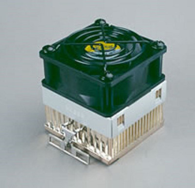

Reply 1 of 18, by PC Hoarder Patrol
That's a lot of weight (suspect beyond both the socket & processor max specs), especially if it only has the centre socket tab attachment strap - would be better if it was the CU5TB/F with the triple tab strap.

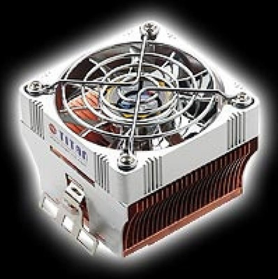

Reply 8 of 18, by PC Hoarder Patrol
^Agreed @lb - my main concern was the retention strap being single point only. I've a few dual skt370 boards currently using coolers of a similar weight (of solid copper coated with silver) but they have the triple point strap - the Akasa Silver Mountain v1 (the v2 is even heavier at 1.25lbs), although I've long since replaced the near 7000RPM fans!

Reply 10 of 18, by Tetrium
The official max weight for a HSF for s370 was 180 grams.
For sA it was something like 300 grams, even though the sA Athlons always seemed somewhat more fragile.
And I agree with the triple tab strap HSFs being more preferable 😀
