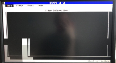

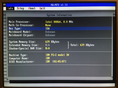

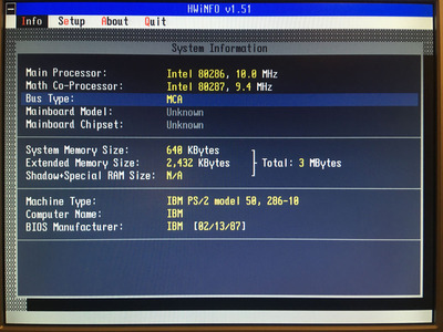

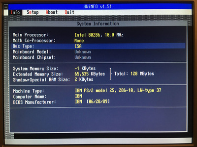

Nice to see support for pre-386 systems. I tested v1.51 on my older IBM PS/2-s a few days ago.
On the Model 30 (8530-002) everything seems to work except "Video Information" - screen goes blank after checking for Matrox MGA. I can still quit the program by pressing "Esc" a few times and then the DOS prompt looks okay, but when i run the program again the display is corrupt (partially shifted to the right).
Model 30-286 (don't know the exact model, it's a bare motherboard) gives a fatal error when checking for GUS on port 250. Also, the "System Information" shows wrong memory sizes, the machine has 1Mb (4x256Kb SIMMs). Not sure if the machine type is correct or not, AFAIK the models 30 and 25 used the same motherboards.
The program seems to be lacking the MCA adapter detection part on Model 50 (8550-021), it shows the bus type as MCA but no adapters are listed. Otherwise seems to be working OK.

Reply 56 of 117, by Mumak
andunn wrote on 2021-12-02, 09:04:
Nice to see support for pre-386 systems. I tested v1.51 on my older IBM PS/2-s a few days ago. […]
Thanks! I'm analyzing those reports to see how can I fix/improve things. Just one question - on the Model 30 are you sure the video adapter problem starts right after "Checking: Matrox MGA-I, -II, -64"? Is it possible that there could be something else shown afterwards?
Reply 57 of 117, by Mumak
Posting v1.61 in a attempt to fix the PS/2 issues you've seen (except the hang at GUS check).
BTW, "IBM PS/2 model 25, 286-10, LW-type 37" and "IBM PS/2 model 30, 286" share the same PC Model IDs, the difference is in BIOS date. "06/28/89" should be the Model 25 according to sources, though not 100% sure about this.
[version pulled as there's a newer one]

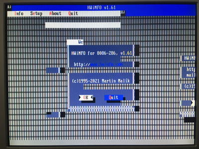

Reply 58 of 117, by andunn
Mumak wrote on 2021-12-02, 09:24:
On the Model 30 are you sure the video adapter problem starts right after "Checking: Matrox MGA-I, -II, -64"? Is it possible that there could be something else shown afterwards?
Took a video clip of the screen with my phone and indeed it shows "MediaVision MVV452" before the screen goes blank. Couldn't see that before, it's only a few frames in the video and too fast to see with bare eyes.
Reply 59 of 117, by andunn

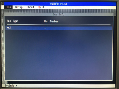

Mumak wrote on 2021-12-02, 10:30:
Model 30 still has the blank screen issue, wierdly the image corruption on next program launch does not appear every time.
Model 30-286 memory amounts are fixed and everything else seems to be OK too.
Model 50 MCA bus info is still not working, when I hit "Enter" an empty "MCA Slots Configuration" screen appears for a fraction of a second and then goes back to the "Bus Info" screen.
