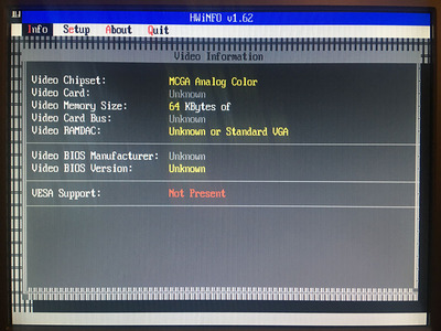

andunn wrote on 2021-12-02, 13:53:
Model 30 still has the blank screen issue, wierdly the image corruption on next program launch does not appear every time. Model […]
Mumak wrote on 2021-12-02, 10:30:
Posting v1.61 in a attempt to fix the PS/2 issues you've seen (except the hang at GUS check).
Model 30-286 memory amounts are fixed and everything else seems to be OK too.
Model 50 MCA bus info is still not working, when I hit "Enter" an empty "MCA Slots Configuration" screen appears for a fraction of a second and then goes back to the "Bus Info" screen.
Thanks for the report!

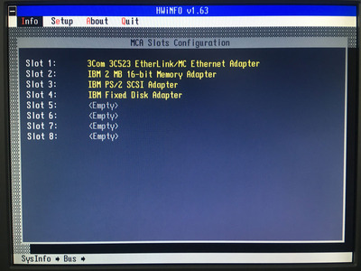

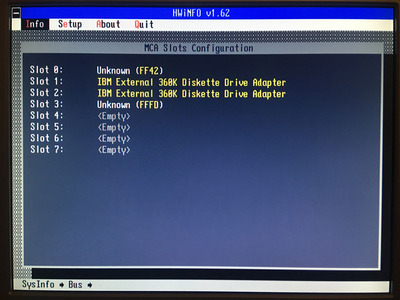

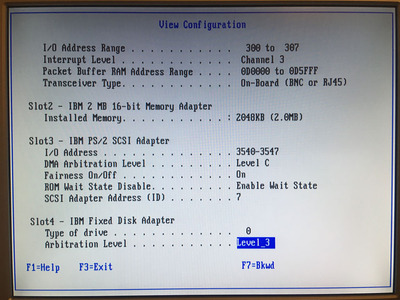

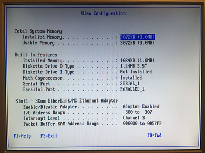

Reply 61 of 117, by andunn
Mumak wrote on 2021-12-02, 18:42:
Posting v1.62 to hopefully fix both issues:
Video issues on the Model 30 seem to be solved and everything else looks OK too.
The MCA slots configuration screen now shows up on the Model 50. However, the adapters listed are incorrect - see attached picture of IBM's config utility.

Reply 62 of 117, by Mumak
andunn wrote on 2021-12-02, 21:52:
Thanks!
Here's v1.63 to fix the MCA details:

Reply 63 of 117, by andunn
Mumak wrote on 2021-12-02, 22:26:
I have good news, everything works now!
Thanks!
