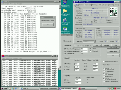

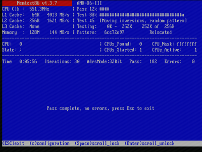

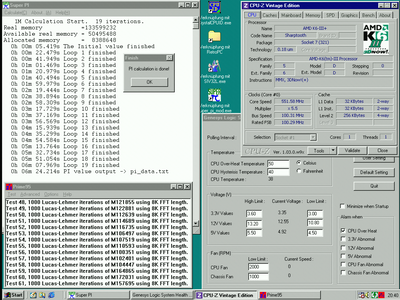

Got a bunch of K6-2+ 450ACZ today. Picked one of them and was able test this mod successfully.
AMD-K6-2+/450ACZ
2.0V CORE/3.3V I/O
A 0030MPMW
1.06 MiB
1906 views
1.07 MiB
1906 views
637.54 KiB
1906 views
-Max stable clock without mod: 550MHz @ 2.0V
-Max stable clock with L2 Mod: 550MHz @ 2.1V
-does not run at 600MHz (not even at 2.4V)
-The die color is red instead of blue like my 500ACZM
@Sphere478
I read your pm and keep an eye on it. Can't reply to your pm yet, because of my newbie status (need more posts).

Fritzchens Fritz wrote on 2022-03-03, 20:35:
Got a bunch of K6-2+ 450ACZ today. Picked one of them and was able test this mod successfully. […]
AMD-K6-2+/450ACZ
2.0V CORE/3.3V I/O
A 0030MPMW
2022-03-03_185604_393___57W_2.0V_550MHz_128KB___450ACZ_0030MPMW.png 2022-03-03_203944_045___60W_2.1V_550MHz_256KB___450ACZ_0030MPMW.png
@Sphere478
Cool, thanks for that. This is the first to confirm my theory about the CPUID changing as well. It'll be good to see if this is the same for all CPUs this works on.
