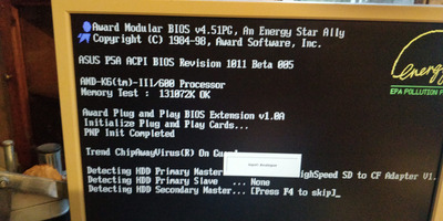

Mod is successful on my side as well !
Thanks a lot for discovering this mod everyone !

Reply 285 of 600, by Deksor

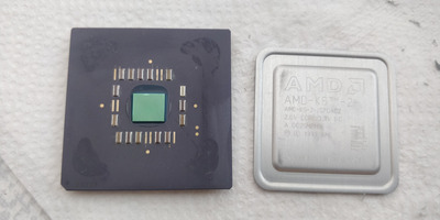

No, I don't think thermal is that big of a deal for those chips. Especially in the conditions we're gonna use them. I mean they were designed to be used in laptops with potentially bad cooling, whereas now they're used on desktop motherboards with beefier coolers 😀
If I wanted to do some heavy overclocking that would probably be a bigger concern though (maybe other mods could be made for those chips for cooling ?)
Reply 286 of 600, by Nemo1985
There wasn't any dried thermal compound under the lid?
I think it's a good idea to change it, to my experience the best for such things is the Artic Silver 5, it didn't dry in like 7 years on my old pc.
600 is a good overclock and ideally the limit of k6 architecture so very good work nonetheless 😀
Reply 287 of 600, by Deksor
Well I'm not sure it's actually dried thermal compound. I wonder if it's not some kind of thermal glue (Or maybe it became like glue after 22 years). Maybe I'll replace it at some point. But so far so good.
Reply 288 of 600, by Sphere478
I’m still trying to figure out what exactly that stuff is.
The hardscape stuff I found isn’t quite the same but looks similar.
It is adequate enough at thermal transfer though.
I really want to get ahold of some artic silver thermal epoxy.
Stupid ebay seller that sold me the other epoxy didn’t send both tubes.
If anyone has the ability to look up pattents or whatever and figure out the glue used please do tell.
