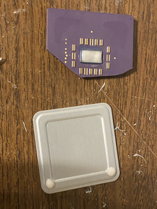

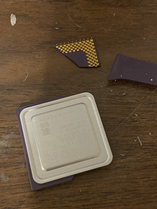

Reply 342 of 600, by Sphere478
Nemo1985 wrote on 2022-03-16, 21:53:
I don't see any good reason for using glue on the die.
If the thermal paste get dry (it will), the same does the glue, with the con that probably won't trasnfer heat as fine as thermal paste, even if it's not a hot cpu lower temperatures on the core are always better even for longevity.
It would be interesting to compare the glued cpu cores and the thermal paste ones.
The Epoxy that I have been using is meant for thermal interfaces. (Thermal adhesive)
I also had good results with urethane. It seems no matter what you use, it’s going to work. Unless it’s liquid metal. Don’t do that unless you replace the IHS with something different.
My main concerns are around making the cpu hold up to time. Decades from now it would be nice if we could still enjoy it.
I have a shattered k6-2 cpu
I could do some removal tests with the epoxy, or other tests if anyone has suggestions.

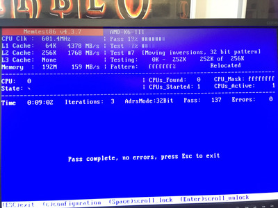

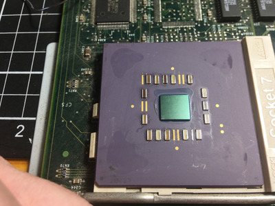

Reply 344 of 600, by Vegge
I've also done this mod to a 570. I used a scrap s7 board to hold the cpu in place while working on it.
1.34 MiB
2048 views
1012.32 KiB
2048 views
Cpu works great at 100x6. Went from a regular k6-2 450 to this, it gave a nice boost to the system.
I mounted the IHS with what I found here at home. Noctua paste on the core and some loctite quick gasket at the corners.

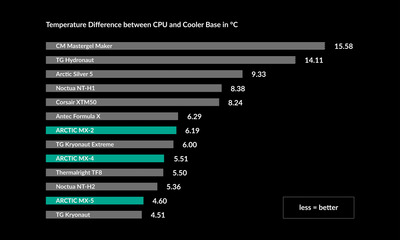

Reply 349 of 600, by cyclone3d
Arctic MX-5 is over 4x thermally conductive than that thermal epoxy. (6.0W/mk). Or is MX-5 higher? Where do these numbers come from?
And I would only consider it a good compound because it is decent enough for most things and should not dry out.
See here for a review of some current compounds.
https://www.tomshardware.com/best-picks/best-thermal-paste
The highest one tested as far as regular compounds is
Thermal Grizzly Kryonaut at 12.5W/mk.
I've used it before but it is kinda expensive.
AS5 vs Thermal Grizzly Kryonaut
https://youtu.be/MmUHNZzD254
Here is Arctic's test for their MX-5. I looked at their documentation and they don't list the thermal conductivity:

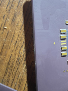

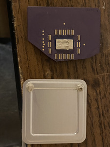

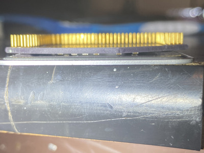

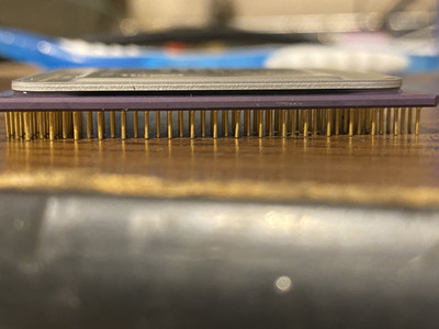

Reply 355 of 600, by Sphere478
Just popped the epoxy loose.
https://youtube.com/shorts/E5soi2jcDmg?feature=share
A little leverage under the IHS and it just popped right off. After that, all of it was able to be broken loose by finger nail and plastic scraper, revealing a pristine cpu ready for a new adhesive. Including what was attached to the core top.
I’m gonna try out the polyurethane next. It takes quite some time to set up good though. Like a week. But seems quite strong once done.
Sphere's PCB projects.
