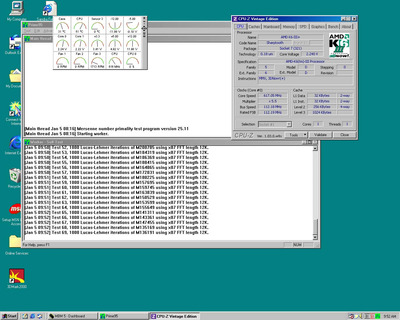

Reply 369 of 600, by Repo Man11
I'm going to try and put the IHS back on my 570. Here's how it performed with a bare core with a very basic Socket 7 heat sink with an upgraded fan and Arctic Silver 5 running Prime 95 for about an hour:
