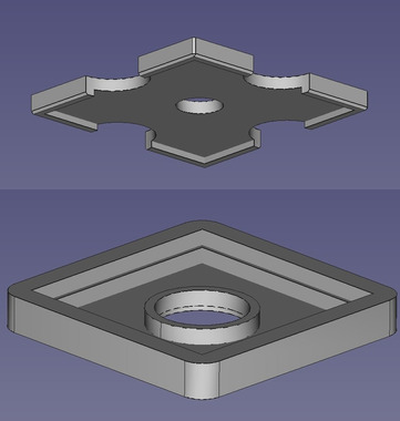

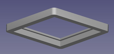

We need a 3d printed alignment tool for reinstalling the ihs squarely anyone able to make one?
Something really basic like this one? CPU on flat surface and set this on top of it. Height is a few tenths less than CPU so you can add some weight on it.
I haven't printed this yet but on next week I may have some time to play with it.
Ooo sweet!!! Anyone with a printer able to send me one? I’ve been doing a bunch of these. And could use it!
If you are sure it fits, post the file and I’ll add it to the guide.

Sphere478 wrote on 2022-03-25, 00:45:
I'll test it properly next week. I can make a draft today with another printer to see is there hope. If it fits I'll post the file. I can post one (not the draft) to you also, lets see. Fitting must be quite accurate and design may need some tuning. Added some estimate of shrinking and print overshoot so that it should fit.
I wonder if there is a way to design this where it covers the top and bottom and allows me to put a clamp over it? It would be useful for when using epoxy on the core, get it thin as possible
Yes, that can be done. I can make a sketch. Actually that was my first idea, but then I decided to make it easy and simple as possible.

Sphere478 wrote on 2022-03-25, 07:38:
Sweet! Lookin forward to what you figure out :p thanks!
Case fitting could be two tents narrower. Lid fits but is a bit on the tight side. I think it would be perfect after some scraping with knife. In the end it should work well enough.
Just made a quick sketch of the "two piece idea" and it prints already. This is just to test dependencies of two joining pieces.

Sweet!!!! That looks perfect!

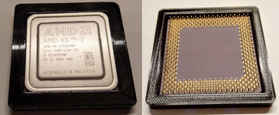

Reply 413 of 600, by fool

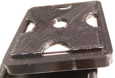

Found acceptable dimensions. Looks like a good fit on the loose side so you don't have to hammer it down.
Some kind of "handle" would be great on the roof part, but it would also make printing much more difficult. I think it's fine as it is for a couple of glue jobs.

fool wrote on 2022-03-27, 16:48:
Sweet! Post 3d file and I’ll add it to the guide?

Reply 415 of 600, by fool
Sphere478 wrote on 2022-03-28, 02:34:
Can you send me one? :p
I think it's possible if you cover expenses and you really want this 🤦

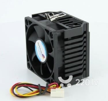

I redid the IHS on my 570E with the Ultra Black, and tried out a new Socket 370 cooler. These are available on Ebay for $10.00 plus shipping. It runs a little cooler, but the installed fan (same size, both 60 MM) runs about 2,000 RPM less, so lower noise level.

As far as overclocking goes, I can hit 616 on my Epox board with no issue; that's the speed I've left it at. In my Soyo board I could hit 620 (5x124) with this cpu, as well as with my K6-2+ 550, but when I try it in this board it won't always POST, etc. So I'm going to recap my Epox board to make sure that isn't the issue. I ordered the caps today.

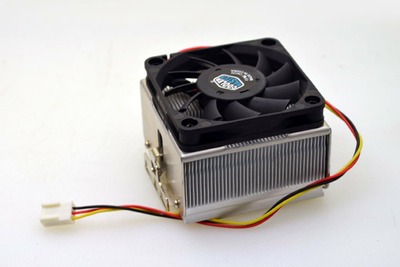

Reply 419 of 600, by Tetrium
Repo Man11 wrote on 2022-03-29, 17:47:
This HSF looks rather nice. It's also quite similar in design to one type of stock sA HSF that used to cool my Barton 3200+ though that HSF had a copper base.
