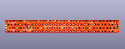

Reply 106 of 192, by Sphere478
Edit: out of date, read farther
Here is the latest version.
3.3v PCI Converter Beta 3.14159.zip
3.36 MiB
61 downloads
-added gnd,
-dropped 3.3/5v pins
-removed solder jumpers
-improved labeling
-figure electrolytic can caps can be used on the existing terminals should user wish for it.
    194.67 KiB
    1245 views
    128.71 KiB
    1245 views
    123.12 KiB
    1245 views

Reply 107 of 192, by mr-spain
Sphere478 wrote on 2022-10-04, 03:07:
Here is the latest version.3.3v PCI Converter Beta 3.14159.zip […]
-added gnd,
-improved labeling
That is awesome, thanks! Any particular places you reccomend for PCB work? Quick turnaround is a plus.

Reply 116 of 192, by mr-spain
OK all wired up, checked OK, 5v tested good in the slot and went to test with my 3.3v mx420 - it gave me a post beep which it never has done before, but no output to the monitor. I'm not sure if this is a function of signaling voltage or failure to get one of the connections soldered, although they all checked ok with my meter. That's the only universal video card I have so I ordered the ubiquitous rage from amazon to test tomorrow.
Reply 117 of 192, by Sphere478
Is the mx420 that you have a card that needs 3.3v I take it? It didn’t work before in this mobo I take it?
Yeah, that rage xl cool card, That is a card in need of 3.3v for sure! Should be a good test.
Be sure you are checking for shorts thoroughly.

Reply 118 of 192, by mr-spain
Sphere478 wrote on 2022-10-12, 01:18:
Is the mx440 that you have a card that needs 3.3v I take it? It didn’t work before in this mobo I take it?
From what I can tell, it went OK as far as shorts. I checked 3.3v to ground on all of the solder connections and no connectivity, and ground were all good. I will also check for any shorts to data/io/whatever pins later.
Yep the card I have on hand (actual part number MX42064) needs 3.3v and it gave me a post beep, can see numlock activity, just no monitor output. I'll test with the Rage and then if I have no output there either start drilling down.
Reply 119 of 192, by Sphere478
What voltage are you getting on the pins that I had on the last version?
Last version had no ground taps
Had 3.3v taps and 3.3/5v taps.
We removed the 3.3/5v taps because it was assumed that those would probably be 5v anyway. And it would just be a pointless feature.
Did you bridge the 3.3vsb tap?
