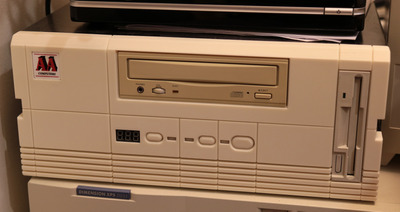

It's one of the things I spent time on since I got my 3d printer a couple of years ago. I've successfully fit a 486 and 386 baby AT motherboards into two different mATX cases.
You can see pictures of my adapters here: Re: Bought these (retro) hardware today
My 486 case is an unknown make full-height mATX desktop case with an SFX PSU. I bought it specially because I could see that unlike many mATX cases, the standoffs could just be unscrewed, so adapters can sit much lower with no risk of screws causing shorts.
My 386 build is in a Yeong Yang A200 case, which was my reference 3d model as someone shared very detailed design files for it. It has pressed in standoffs and works great with the 3mm 'riser' to stop the board shorting on the standoffs. Somehow the case was sold with no front panel, so of course I made one with the 3d printer and made it a desktop instead of a tower:
657.26 KiB
1506 views
The files can be had here if you've got a 3d printer: download/file.php?id=92248
You can make some adapters that sit the motherboard 3 or 4mm higher than the original standoffs, then there's a separate riser for the card slots. I recommend to print them in PETG since PLA can warp at quite low temperatures.
