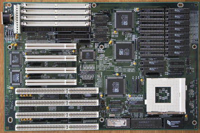

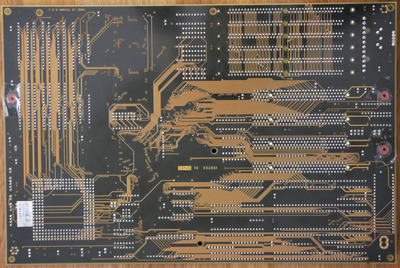

Reply 8 of 162, by ChrisK
Some socket 4 board pictures:
Gigabyte GA-586IS (REV 3):
https://www.ultimateretro.net/en/motherboards/2742

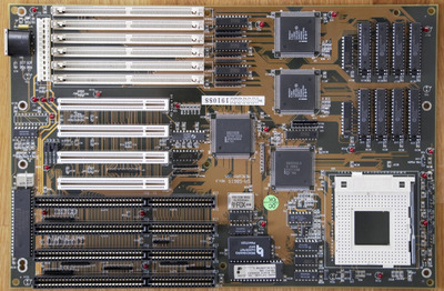

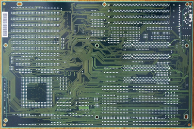

ECS SI5PI AIO (REV. 1.1):
https://www.ultimateretro.net/en/motherboards/2180
1.69 MiB
4316 views
1.85 MiB
4316 views
