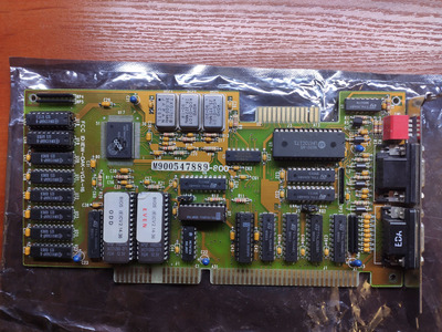

Got this board, it's not detected by bios.
962.22 KiB
1100 views
Probing the power lines I see some suspiciously low resistance (88 Ohms, or 0.17v drop when measuring in diode testing mode).
It's not dead short, but still way too low. To avoid desoldering all tantalum capacitors I started with taking out all the socketed chips.
It turns out the dead IC is the PAL16L8 close to ISA connector, the one in row with 74LS244 buffers.
I think I would be able to replace it with modern GAL16V8 from Microchip, but I'd need the equations from the original chip. The original PAL is of L series, so just plain logic, no registers, and I think it would be relatively simple to probe the behavior of the original working chip. Or maybe I could reverse-engineer that piece if I had a schematics for that card.
Does anyone has this card and would it be possible to read/probe its content, or at least any hints on where to look for the board schematics?

Reply 3 of 12, by vstrakh
Seems I have a bit of luck with reverse engineering approach.
The dead PAL is only involved in generating IOR#, IOW#, ASEL and RESET signals for the OTI-37c, so basically only detects the addressing of VGA memory area and distinguishes I/O ports access from DMA transfers and refresh conditions. It's not involved in other onboard details, like the timings, data flow orchestration or BIOS chips mapping onto the bus. All the signals are coming directly from the ISA edge connector, and outputs are going into oti-037 directly or through 7404 inverter.
So I hope it would be just some looking into ISA specs and a bit of head scratching to map the i/o access logic.
I'm not sure yet if IOR#/IOW# are depending on the address lines or oti-037c filters addresses on its own. The datasheet did not include typical application schematics and the block diagram does not include needed details.
Googling around I see that ISA cards often/typically only decoded 1K of I/O address space, and not full 64K.
This matches well the A9-A4 lines I see on that PLA, so the answer should be "decode the addresses yourself on that PLA".

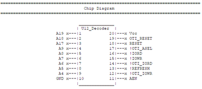

Here's the pinout of that PAL design.
16.57 KiB
1015 views
Wrote the PLD design that decodes I/O ports access signals and VGA memory areas. It all looks ok in simulation, but still didn't bring up the card to life.
It's possible some other ICs are not ok, so I'd need a full-blown debugging on a breadboard (don't want to risk the motherboard's health).
Ordered some ISA edge connectors from Aliexpress...
PS: I know the card is garbage, it has only 8-bit data path to the video memory. I'm just kinda enjoying diving deeper in old hw, brings up memories 😀

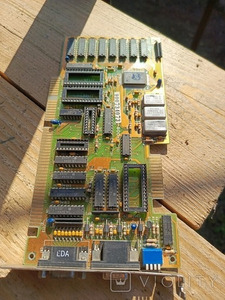

Hi. I've found this beauty on Violity and bought it just because of this topic.
It's exactly your card model (there are few of them) but in worse shape - BIOS, DAC and both PALs are missing.
DACs are quite standard, I have one or two and even ordered CEG ones from EDSUN (AD?) to play with this interesting technology.
BIOS is also available, though if you provide yours it would be much simple to be in sync.
But mine missing both GALs and that makes everything even more interesting 😀 But why else we are here?
Could make a dump of a working one (vertical, horizontal?) and provide JED file for the one that is broken in your case. I can try and see what do we have.
I am not very experienced, especially in PAL programming, but at least I have XGecu, oscilloscope and some time to have fun 😀
I only hope it was salvaged while being working.
Also, is your working in EGA mode? I suppose one of the PAL is for VGA part.

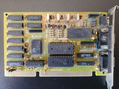

Dear friends, I think I have a similar card. How can i help you? How do I read the chip with an EPROM reader/programmer?
Reply 12 of 12, by vstrakh
Toninetto wrote on 2024-04-27, 14:52:
I don't think it's possible with your card. The main chip is the same, but surroundings are different. Yours doesn't even have two PAL chips, there's just one.
The PAL chips are used as a programmable glue logic, it is very specific to the actual schematics of the video card model/revision/whatever. It just glues different things on different cards, so does it differently. Your card is definitely not identical, so the logic in PAL will be different.
