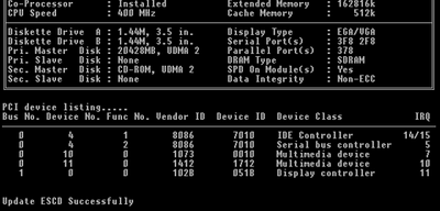

I am hoping that CPUZ will tell me how much L2 cache I have. Specs found online all say 1mb so I guess I will rip out that extra 64mb (sad face).
Personally I don't trust software, I just look at the chips on the motherboard. But failing that, just look at the POST screen. It normally shows cache, like here:
33.09 KiB
1631 views
This is a system with 512kB L2 cache, yours might show more.
