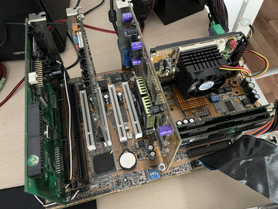

In this initial video, I'm testing the 1 GHz VIA C3 "Ezra-T" (default FSB: 100 / multiplier: 10.0), which - based on my experience with 7 identical CPUs - can be easily overclocked to at least 1.2 GHz (FSB: 133 / multi: 9.0). I went with 1.26 GHz for this test (FSB: 133 / multi: 9.5), because I was able to hit this frequency with all my CPUs (some required a very small voltage bump to be 100% stable).
Sorry for the quality, it's not particularly good. I do have a VGA capture device, but it only captures at a maximum of 30FPS/Full HD resolution, so I decided to just record the screen with an iPhone 12 @ 4k/60FPS. The sound is recorded separately and synced in post.
FULL SYSTEM SPECS:

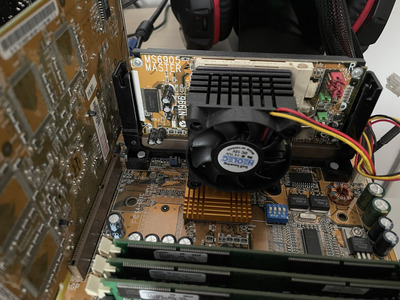

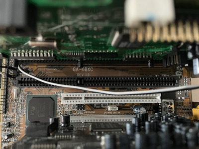

MB: Gigabyte GA-6BXC rev 1.9 (VRM mod)
CPU: VIA Ezra-T 1 GHz (OC @ 1.26 GHz / FSB133 & 9.5 multi) using an MSI MS-6905 "Master" slotket V2 (works fine even with other no-name slotkets, though).
RAM: 3 x 128 MB SAMSUNG SDRAM PC133 (using 3 sticks was a bit faster than with 1 or 2 - might be because memory bank interleave is automatically enabled when all memory slots are populated, though I'm not even sure if the 440BX supports memory bank interleave).

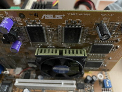

VIDEO: Asus V7700Ti GeForce 2 Ti (OC @ GeForce 2 Ultra clocks)
SOUND: Creative Sound Blaster Live 5.1 SB0220
SOUND2: ESS AudioDrive ES1688F (non-PNP / irrelevant for this test).
HDD: Seagate 40 GB IDE/PATA

A few pics with the Ezra-T test system:

I have a ver 1.7 of that motherboard. Wouldn't mind if you shared the VRM mod if it will work.
The mod is nothing spectacular, it's just a matter of replacing the existing VRM chip (HIP6004ACB), which only supports 1.8V or above, with a HIP6004BCB chip that supports voltages greater than 1.3V (they are available on eBay for $5 or less). I don't have a GA-6BXC rev 1.7 (I only have rev 2.0 and 1.9 boards), but I'm guessing the 1.7 should be pretty similar to the 1.9.

No, that mod is just for this particular revision (1.9) of the GA-6BXC motherboard. The GA-6BXC rev 2.0 (and many other Slot 1 boards) already support voltages down to 1.3V. In fact, if a board supports Coppermine CPUs it probably also supports the VIA C3 CPUs (I've tried them on many boards and have had no issues).
Regarding the slotket situation: I've tested multiple slotkets, including two for which I paid $5 a piece and they all work perfectly well. The VIA C3 CPUs are very efficient (they require little power, especially when compared to a Pentium 3 Katmai, for example), so any slotket that supports Coppermine CPUs should work with them, even the cheaper ones.

That too, and the GA-6BXC has 3 ISA slots, which is awesome. Not only that, but I didn't encounter a single resource conflict issue with any of the ISA cards that I tried (and I tried everything: SBPro 2, various ESS cards, various Yamaha cards, SB16, AWE32, etc).

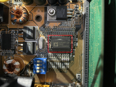

Reply 9 of 200, by bloodem
Doornkaat wrote on 2022-02-16, 09:59:
Didn't know about the FSB control thing. Is that exclusive to GA-6BXC? If not do you know of any other boards that allow for it?
It's not really about the board, but the PLL/clock generator chip which needs to be supported by the software (such as RayeR's SMB)
The list of supported chips is pretty small:
"It can read and set FSB/PCI speed and spread spectrum on few supported PLL chips: Winbond 83194R-02/04/39/39A, 83195R-08, ICS 9148-26 and CY 28349"
The GA-6BXC (at least rev 1.9 and rev 2.0, which I have) have the 9148BF-26 PLL chip, which is supported (see attached pic).
I'm guessing that there have to be other boards that use some of these PLL chips, but I haven't come across any of them (or did not pay attention to this at the time 😅 )
Edit: Have you done anything about the AGP power issues on that board btw? Or does it work fine?
It doesn't really have any big power issues, just the typical for the era (LX8383A voltage regulator for 3.3V at a max of 7.5 Amps).
I even tried a GeForce 3 Ti 500 on it (which is a power hog) and it works perfectly well, but the LX8383A does get extremely hot with that card - so a small heatsink and airflow for the voltage regulator would be highly recommended for day-to-day use with such a card.
And as for GeForce 2 cards, these have very low power requirements, so they all work great and the voltage regulator stays below 70 degrees C. Anyway, all in all, it's much better than a lot of SS7 boards (some of which can't even handle a Voodoo 3 3000, like my Lucky Star P5MVP3).
I think the revision 2.0 of the GA-6BXC board has an improved AGP power delivery, but did not thoroughly investigated this (as I said, not a big issue on the rev 1.9 either).

Judging by your photo, your memory use high density chips (4 per module) which just don't have enough banks for maximum memory interleaving. Although I don't remember if 440BX even had support for interleaving.

The Serpent Rider wrote on 2022-02-16, 11:31:
Yes, thought about that too, but I also tested with older Kingston modules (with 8 chips per module) and there was no difference.
So I settled for the Samsung because I have MANY laying around.
