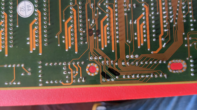

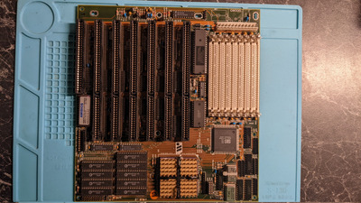

It seems I do not have any luck in getting an working 486-era mainboard. I got an PAT48SA-1.30, which is an ISA-only 486 DX50 board, but it looks like it is dead. 🙁
I snipped the Varta battery as it was in the beginning of leaking. The leakage was only minor and most of the acid went into the keyboard connector. I took it of to check if there were traces underneath. But I was lucky and it seems the leakage does not caused any harms. But at the initial power on the 12V tantal blew up and the board did not post. No picture, no beep, nothing. I switched the RAM modules but even without any RAM no beep.

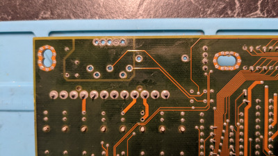

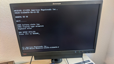

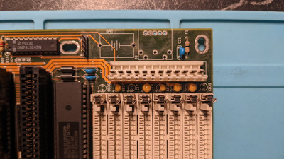

Success. I started checking the underside of the board for broken traces. i found a single one, which was affected by the battery leakage. Just this single one. It connects from the 74LS245 right before the first ISA slot to a via and then on the top side to the ISA slots. I temporary bodged it and the board came to life. 😀
I should replace the three passives (one resistor, two diodes) which were affected too. Strange that the parts look okay from the top side. The board must have sit in a drop of battery juice on this spot.
