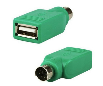

An USB-to-PS/2 converter might be the quickest solution. Once connected with PS/2 port, the mouse can be activated using "mouse.com" of MS-DOS as long as it's Microsoft Mouse compatible.
Not every converter works on every USB mouse though; I've got half a dozen such converters from years of buying Microsoft mice. While they all work with newest USB mice from Microsoft, they seems not capable of converting Logitech or Asus mice correctly.
of course, that didn't even occur to me. Yes, if that hasn't been tried yet, sure. Then it technically isn a "USB mouse" but a usb/ps2 combo mouse.
Meaning, that mouse has to be built to support ps2 connection.
The adaptors are usally green. Black or purple ones, usually for keybards and iirc, wired differntly.
There's no real effort for the manufacurer to build a ps2-backwards-compatible mouse, so many will be.
E.g. I use a fairly recent tiny Lenovo Thinkpad mouse, all black generic piece, did not come with the adapter, but does work on ps2 with a random one from Logitech.

Well, this particular setup doesn’t have ps2
Those little green adapters are nothing more than wires going between pins.
If a mouse works on ps2 it is because that mouse supports talking in usb or ps2 over the data wires.
This is off topic, but thanks for the suggestion. A good answer for many who will search this thread I’m sure.

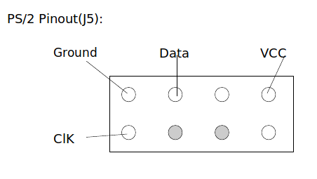

Then, get the nex best generic "ps2 bracket" from ebay, they mostly come with a 2x4 plug and should work.
Worst that can happen is that you'll have to check the "ps2 pinout" in the manual and rearrange the cables, but not likely, they did not reinvent the wheel all the time.
Especially likely if you're not using an asus.
https://flaterco.com/kb/Pentium/MouseBracket.jpg

It’s sounding like this is what I may do, make a header.

I think your best bets are (in order from most recommended to least recommended IMHO) :
1. Use the BIOS, Luke!
Your system looks recent enough to have a USB BIOS ( does a USB keyboard work in BIOS setup ? ) , which should be emulating a PS/2 mouse using your USB mouse.
Then you can use the standard Windows 3.x PS/2 mouse driver.
This is basically what everyone does.
Is it not working for some reason ?
2. Use a USB stack for MS-DOS to emulate a PS/2 mouse.
E.g. http://bretjohnson.us/ is a full featured USB stack for MS-DOS that I've used in the past.
It even contains a program called "USBMOUSE" which does exactly what you need: it emulates a PS/2 mouse using the USB mouse.

It (the bios) supports usb keyboard but usb mouse is not working I haven’t tried the keyboard on usb in win 3.11 though.
Writing a driver is way above my skillset 🤣
