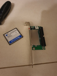

Reply 42 of 46, by idan182
THANK GOD
it was this chinese junk CF card along with this CF to IDE thing:
I bought this from Amazon:
33.88 KiB
389 views
And it works and everything recognize on post now!
All the storage that was on the CF card got deleted! now it asks me to format it. huh
So good I have backup.
Reply 43 of 46, by Sphere478
idan182 wrote on 2022-03-29, 18:05:
THANK GOD it was this chinese junk CF card along with this CF to IDE thing: […]
THANK GOD
I’ve had nothing but issues with cf on pentium IDE boards
Just go sata and be done with it.
Get a promise tx4 sata II
