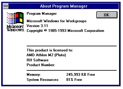

Reply 5 of 24, by red-ray
TrashPanda wrote on 2022-04-07, 04:06:
Its possible that Win 3.11 simply cannot handle 128mb of memory .
No, I have an AMD Athlon with 640MB and WFW 3.11 runs OK. I noticed the WFW only seems to use about 256MB though.
    3.64 KiB
    864 views

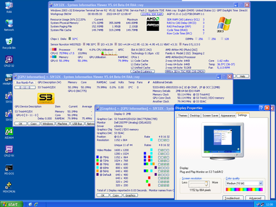

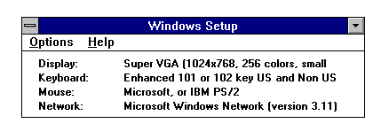

I just tried an S3 Trio64V2/DX on WFW 3.11 and it "just worked", given they cost 11.99 or 19.95 for a 2MB one getting one seems a sensible way forward.
I have attached a screen shot from 2003 so you can see what the system is and what the S3 should be good for on WFW once you get the WFW S3 drivers
    2.51 KiB
    781 views
    1024 x 768 x 8 on WFW with SVGA driver
    89.27 KiB
    781 views
    1152 x 864 x 16 @ 60Hz on 2003 with S3 driver
