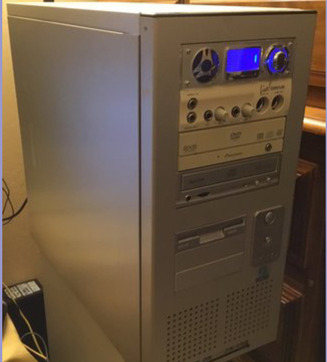

My Mega-Aluminum Monster looks like a Mac Pro.

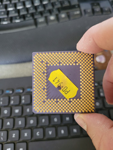

Reply 195 of 253, by SteveC
My mind keeps coming back to this thread... I'm trying to resist!
I don't own a GeForce DDR 256 so I will never be able to win 😀
OK I've started testing some bits.... this Athlon 1000 (would have to underclock it anyway) doesn't work, I wonder why 😁
    222.04 KiB
    1015 views
Reply 196 of 253, by TrashPanda
SteveC wrote on 2022-05-14, 11:12:
The front fell off!!
Reply 197 of 253, by SteveC
I seem to have destroyed my only other Athlon trying to unlock it nooooo!!! This was chipped to hell around the edges already and I must have just finished it off 🙁
Reply 198 of 253, by Necrodude
SteveC wrote on 2022-05-14, 11:45:
Nooooo!
Reply 199 of 253, by SteveC
It's annoying as I don't have anything around the 1GHz range in all my stuff - either much slower or much faster! The Slot 1 build off PC's motherboard only supports the earliest PIIIs, the only working Athlon CPUs I have are 1900XP or higher.
I have a 900MHZ Celeron ThinkPad R30 though! Hmmmm.... Oh it does about 10fps on default install, I don't think it's worth pursuing haha
